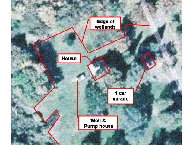

Drilled a 200' well and installed a submersible pump system for a new house in the country. Everything was disinfected, tested, sealed, and producing good water. A few years later I was called because the family was complaining about low pressure. Since I was last there a well house had been built over the well, pressure tank, and controls. Upon opening the door it was immediately evident that someone also had the bright idea that the heated well house could double as a chicken house. The area around the well and pressure tank had been screened off with chicken wire, which did keep the chickens away from the well area. The area around the well was still fairly clean as compared to the rest of the chicken/well house. However, someone had removed the screened elbow from the well seal, leaving a ½" open hole looking down the well. About the time I noticed this, someone in the house started using water, and I heard the pump start. My presence in the well/chicken house had just scared off all the chickens and the commotion had stirred up the air in the room. I noticed little feathers floating in the air and soon also noticed a stream of feathers flying down the ½" hole in the well seal. As the water level in the well was being pulled down, the suction was drawing in dust, feathers, and anything else that was floating in the air. I pointed this out to the home owner, which then started telling me they had noticed a smell in the water, and that the kids had been having frequent illness's.
Upon pulling the pump we found the intake screen sucked in and clogged with feathers. Bailing out the well we found some really nasty looking stuff. We did not think it possible to properly disinfect the pump, pipe, and wire in the well, so all new equipment was installed, and the well was disinfected and properly sealed. It took several more disinfections to get rid of the contamination but, we finally did get the well back to a usable condition. Just goes to show that even a properly installed and sealed well can turn into a real mess when the well head is not kept in a protected area.

On a recent job I was sent to a home in an out of the way town that in many respects is a bit backwards to even the next town over. There are a few different types of residents in the town these days as the inevitable change is happening. The first is the backward 100 years in the past type. Then we have the wealthy farmer that discovered that property value is easier work than farming. Then we have the hippies that moved to the boondocks for peace and quiet. Finally we have the yuppies that have discovered the last deal on real estate in the area. If Barbie came from this town this is what she would look like.
The call was no water coming out of the sink faucet. Yea, a quick and too easy job that I wish someone had visited this forum before calling my company. I was familiar with the street and quickly thought about which houses I wish it would be and which ones I hoped it wasn't 3 of the 4 types I listed above are represented on the street. The wealthy farmer would have been smart enough to fix it himself.
I turned onto the street the first house was numbered too low...
the second was one of the ones that I was hoping wasn't the call and Damn!
The third was too high. I turned back and pulled into the backwards looking shack. The old timer with a somewhat toothless grin meets me at the door and brings me in through the kitchen. The kitchen sink has a hot faucet and a cold faucet no aerator there... Into the bathroom where there was a relatively new single handle Delta faucet on the lav sink.
Sure enough barely a drip coming out of it when full open. I unscrew the aerator and it has a dense chunk of greenish brown fiberous sludge packed against it. I cleaned it off the aerator and ran the water with out the aerator several minutes to flush the line and faucet. a few chunks came out but they seemed to stop. I put the aerator on and ran it about 15 seconds later it was clogged again. I repeated the process several times with the same result. Recognizing that I was flogging a dead horse I ask the old timer about his well...
He proudly replies that he has a hand dug well! He then points out the back window to his well shed. Oh boy! I explain to him that our company does not do well repairs, or, water treatment, and get on down the road as quick as possible to a profitable job...
Now for a bit of background on the old timers property. it is surrounded by swamp land on 3 sides and the road on the fourth. Here is and arial photo of the property. About 20' away from the well is an area of flooded swamp maples water a foot or 2 deep dense mats of algae floating around...
I'm no expert but IMHO these people are drinking swamp water!
