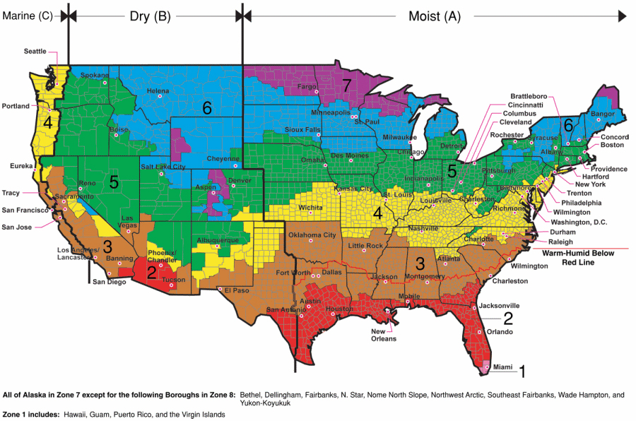

Your foundation wall insulation plan may need some adjustment if you are in a climate colder than US climate zone 5. The R5 may not be sufficient exterior-side R for dew point control with R13-R15 batts on the above grade section, which would result in some amount of chronic wintertime condensation at the foam/fiber boundary, with some potential of getting mold going there. The safer bet would be to put at least the IRC chapter 7 recommended R for wood-sheathed above ground walls for your climate zone, and go with only unfaced batts in the studwall (rock-wool or high density fiberglass preferred, so R15 in a 2x4 wall), and NO INTERIOR SIDE VAPOR BARRIERS any tighter than standard latex paint on wallboard.
That way the ground moisture that makes it through the wall can still dry toward the interior rather than accumulate in the studs & insulation, while keeping moisture from the interior from accumulating in the cavity during the cold winter months.
If it turns out you are in zone 6 it's worth adding 1" EPS inside the XPS bringing the foam-R to about R9, which would give you plenty of margin for zone 6 (and probably OK even in zone 7 if you back off to R13 on the batts). Tape the seams of the XPS with housewrap tape (or better yet, seal them with duct mastic) and use dabs of foam-board construction adhesive to put up the EPS, staggering it's seams with those of the XPS.
With R9 foam and 2x4 6" o.c. and R15 batts that would bring the "whole wall" R to about R21-R22 after factoring in the thermal bridging, which is about right for zone 6. (See table 2, p10 of this document.)

Are you in fact located in climate zone 6? (I'm only guessing due to the "Mount Rushmore State" avatar pic.)
In climate zone 6 with R13 outside the polyethylene vapor barrier you can install up to R23 as fiber insulation on the interior side of the vapor barrier without condensation issues. Instead of 3" of foam board to bring it flush with the concrete you could install R23 rock wool or R21 fiberglass batts butted together side by side, overhanging the concrete by ~2". Install 2" EPS (R8) up against the concrete, and hang a sheet of housewrap over the rock wool as a vapor-permeable air barrier, sealing at the top & edges with caulk/housewrap tape/mastic/whatever and to the foam with duct mastic. When you put up the studwall it will compress the batts a bit, since it's hanging a half-inch or so proud of the foam board, but that's fine. Then insulate the studwall only up to where it overlaps the sandwiched batts by about 3-6". Don't cheap out and use low-density R19s in there- they are too floppy and highly air-permeable. R23 rock wool or R21 fiberglass won't sag, and offer far superior resistance to any infiltration or convection air flow.

Where is the R5 in your stackup for the above grade concrete? If the existing concrete already has R5 XPS applied you only need to add R4 EPS to it for dew point control. (Somehow I thought we were talking about a section of wall that still had no foam.) That would make the 2" of foam nominally R9 instead of R8, which is fine.
An R13 studwall with no foam performs at about R9.5-R10 due to the thermal bridging of the studs, which is way below cost-effective in a US climate zone 6 climate. IRC code min for zone 6 is R20+ 5 (R20 cavity fill in 2x6 studs + R5 continuous insulation, such as foam to thermally break the studs) or R13 +10 (R13 2x4 + R10 continuous insulation.) With the thermal break over the studs those solutions come in at about R20 "whole-wall" after factoring in the thermal bridging. What I was recommending would end up better than code for the portion of the wall with the existing studs, and nearly-code for above-grade concrete part.

I really appreciate all the time you are taking here - great information. By the way, yes zone 6 and yes I already have r-5 XPS up on the concrete. Almost all the concrete is below grade except about 5-10 or so feet above grade where the sidewall meets the walkout wall.
