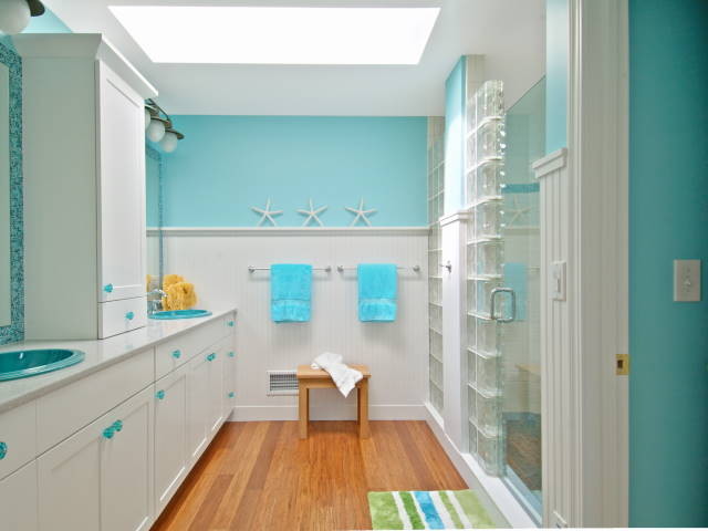

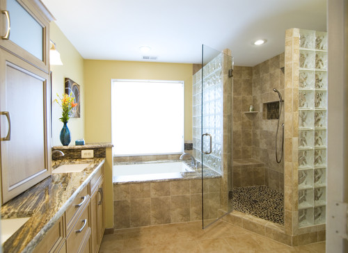

I found this image on Houzz after following the link above. It shows the door hinged on the fixed wall. This contractor came up with a good solution I think to your problem.
Notice how they add some tile work to cap off the end of the blocks....
Clever.
