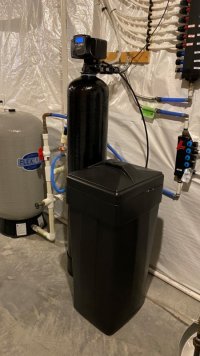

Fleck 5600sxt salty service water and manganese filter?
Dvid
62
Elkhart, Indiana
Summary: Service water is salty, leaves desposits, corrodes. Wanting to know if I need to fix / adjust the system or need to install a Manganese prefilter to help.
Details: We have a well and water softener system and have had our water tested a few times. We know it is high in Manganese and the brine tank tends to turn cloudy and brown despite cleaning it every year. We also remove and clean the build up on the mesh screen filter and white nozzles on the Fleck SXT5600 every year or so. We do use res care to clean the resin. The softener does seem to take care of the Manganese and the water is soft, but we have salty service water leaving deposits on our fixtures and glasses in the dishwasher taste a bit salty. I read somewhere it can be due to the softener combating the Manganese.
It's a pain to keep cleaning the brine tank and filters and the salt takes toll on our fixtures. We are interested in a solution.
Is there something like adjusting the rinse cycle, brine draw settings, cleaning additional parts we can do?
Is there an affordable prefilter that will take care of manganese? We don't need a system that strips everything out of the water because the other levels are fine.
Thank you so much. Ready for this problem to be gone.

Thanks. Gathered as much info as I could.
When we originally moved in it was three of us. Now it's two. Our college son moved out so a lot less long showers and laundry. So I'm sure it needs tweaking. It can go several days (more like a week +) without regenerating. These settings were provided to me and every water tech that's ever come by has has a different opinion, some to make more efficient, some to save salt, etc. So if the settings are way off, please don't "shoot the messenger." I'm not a water tech.

Attaching the last water samples I have from 2020. I know that's too old, I'm in the process of running them again right now. I ran a basic test strip the other day just to get a ballpark idea and the softening looked fine.

With a 10x54 inch tank, which I presume you have, the main thing I would change is to increase the C to as much as 36, and at least to 33.
IMO, your #1 Injector - White is oversized. I would prefer either #00 Injector - Violet
or #0 Injector - Red.
When your softened water dries, it is normal that there be a salt residue, but that wipes off with a damp cloth.
I would program the reserve differently.
RS=rc
RC=120 (gallons of reserve)
