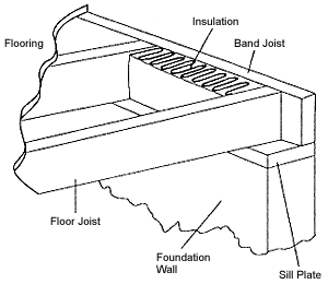

The approach to insulating the band joists works, and would be the right thing to do.
But cut'n'cobbled foam between joists is a waste of good foam, since the R1-R1.2/inch wood is thermally bridging the foam, providing a path for the heat to move around the insulation. If installing foam on the joists it's far better to make a continuous layer cap-nailed to the underside of the joists, and tape the seams to make it an air barrier. Using a fire-rated foil-faced polyisocyanurate (eg Dow Thermax) in that location rather than XPS (Foamular) is a far better choice, since it's much easier to seal reliably using a 1.5-2" temperature rated foil tape (eg Nashua 324a, found in mostt box stores), and doesn't need a thermal barrier against ignition the way other foam board does when used in that way.
But in a crawl space it's usually less foam and more reliable to insulate the crawlspace walls instead of at the joists, but you would need to leave a termite inspection strip, and not fully cover it with foam. Fire rated Thermax can be glue to the foundation wall using foam board construction adhesive, leaving a 3" strip at the top of the foundation where you can cut & fit high-density R15s (rock wool preferable to fiberglass) that youj can just pull for termite inspection. To meet current IRC code minimums in your climate zone (Zone 5B) takes R15 continuous insulation, which would mean 2.5-3" of foam depending on type. The cheapest thing to do would be 2.5" of EPS glued to the foundation, (in 1 or two layers, seams taped and staggered), with a 1/2" layer of fire-rated polyiso on the interior. An alternative would be 1" of EPS trapped to the foundation wall with a non-structural 2x4/R13-R15) studwall with unpainted wallboard on the interior as the thermal barrier for the foam, but that's a lot more labor.
If it isn't already, the ground vapor barrier should be sealed tight to the foundation walls, and it's OK to install the foam overlapping the vapor barrier.
That way the entire crawlspace is now conditioned space, and even unheated there is zero freeze risk, and any "musty crawlspace" smells should go away, since the joists will be in conditioned space, settling in at a moisture content less than 10% year-round.

The band joist aka "rim joist" is the vertical joist on top of the sill plate that girds the entire house. The spanning joists supporting the floor are called floor joists:
In the band joists most local codes usually give rigid foam a pass without the thermal barrier, even if the joists are open, as long as there are no ignition sources nearby. If you covered it with R15 rock wool (unfaced) the rock wool would meet the requirements, and add quite a bit of R.
But the ratio of foam-R to fiber-R has to be adequate for the exact climate zone to prevent frost/condensation build-up over a winter at the foam/fiber boundary. In your relatively dry climate you can usually cheat a bit on foam-R, as long as you don't actively humidify the conditioned space. In zone 5 as long as ~25-30% of the total R is foam the risk of moisture accumulation is low. With 2" EPS is about R8, R8 EPS + R13 fiberglass= R21 total, R8/R21= 38%, you have plenty of margin.
But with just 1"/R4 you'd be at R17, and R4/R17= 23%, so there is some risk of creating mold/rot conditions at the sill plate where the fiber & foam meet in the early spring, but not a huge risk in a dry climate. Cobbling air-tight foam over the sill plate including it's edges takes that risk down even further. EPS is comparatively cheap per-R relative to XPS, and found in most box stores, and quite a bit greener. Polyisocyanurate is too, but it has performance issues at cold temps if it's just a thin layer on the exterior. (An inch of R6 polyiso on the exterior of R13 in a zone 5 or colder climate will underperform an inch of R4 EPS over the winter, even though it will outperform it in the spring and fall.)

Your local orange box store sells 1.5" EPS with plastic facers for about 8.5 cents/R-ft^2. It's low-density "Type-I" (1lb per cubic foot nominal) goods manufactured by R-Tech, labeled only R5.78 (R3.85/inch ) @ 75F mid-foam temp, but at your average winter temp it would run ~R6 if it's the only insulation, higher if it's on an exterior layer. It's the right thickness to insulate any concrete ledge at the top of the foundation up to the level of the foundation sill. So if you first install insulation over the band joist, then the ledge strip (with a bead of can-foam at the foundation-sill/concrete boundary), and then a layer the covers the top of the band joist & ledge strip, you can then cobble a piece over the top of the foundation sill and ledge-foam to completely block the wood from interior side moisture drives. In the remaining space you could then add another layer of foam bringing the band-joist R up to ~R12-ish, or carefully sculpt a plug from high density fiberglass or rock wool batt to completely fill that space.
This is almost the right detail showing foam at the ledge ontinuous with the fall foam but they don't show the lappin layer over the foundation sill that you'd need with a normal-width sill:
With a 2 x 4 sill and a 2x band joist, with only 1.5" foam against the band joist there would be 1/2" of exposed sill plate, so you'd have to double up at least one of the layers (either the ledge or the band joist) to fully cover the sill. As shown there is a low-R bridge or air-gap where the sill and ledge foam meet.
The cut'n'cobbled foam can be cut 1/2" narrower than the space, tacked in place with cap nail &/or foam board construction adhesive, then sealed in place with can-foam. By cutting it narrow it makes it easier to put in place allowing for dimensional irregularities, and leaves a 1/4" perimeter so you can get the can-foam straw-nozzle all the way in, guaranteeing a good air seal.
