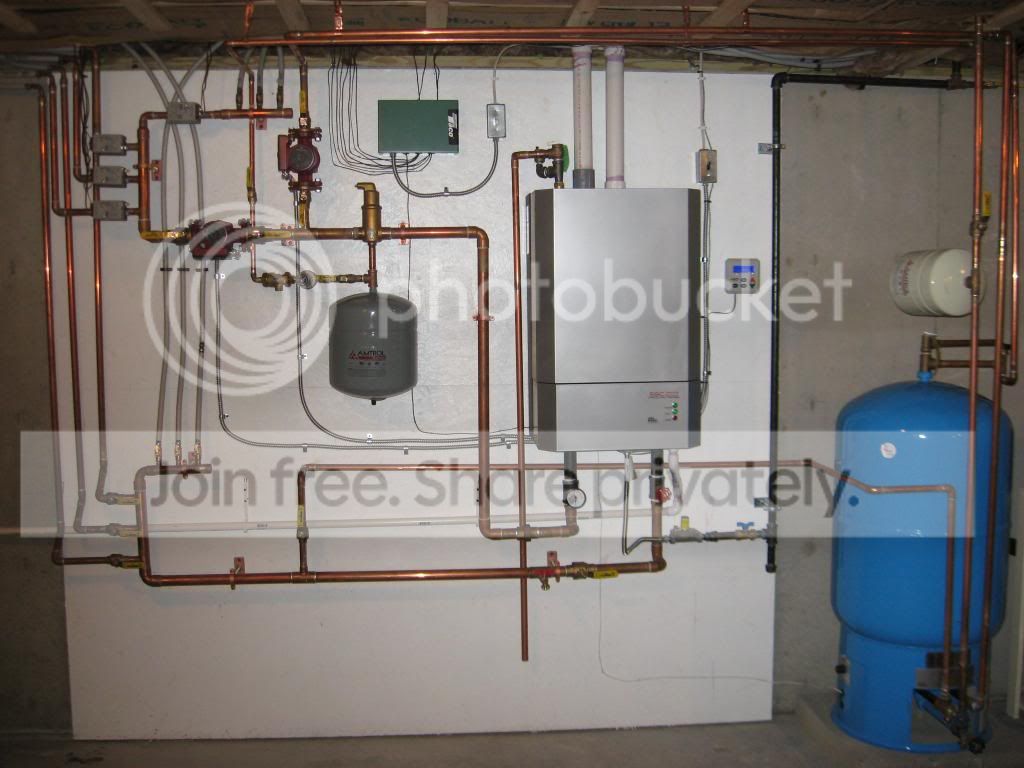

  11. ToddinMaine
    ToddinMaine New Member
    Joined:
    Dec 16, 2012
    Location:
    Central Maine
    [​IMG]
    Thank you, Dana. That's a good deal of information to ponder.
    Above is my system. The supply and return are 1 1/4" dia. before they drop to 3/4", then the 1/2" pex. With pex, of course, the number of elbows is minimal. If I run my circ pumps on the fastest speed, would you feel good about the flow rate through the boiler if I closed that primary loop ball valve?
    With a HW tank/buffer as you described, why wouldn't you want to just pipe it in series with the CH supply piping?
    Todd
  12. Dana
    Dana In the trades
    Joined:
    Jan 14, 2009
    Location:
    01609
    Series plumbing with the CH loop at the boiler output lowers the response time on the system a bit. Putting the mass at the point of hydraulic separation the radiation sees nearly undiluted boiler output when the boiler is firing.
    If you put it in series with the return leg to guarantee that the radiation sees full boiler output, it raises the modulation level of the boiler when it fires up, reducing both the efficiency and length of the burn slightly. (There's no intuitive simple-math explanation that's easy to lay out in a forum posting, but the real math has been worked out by hydronic enginerds doing more than first-order estimates or WAGs like the rest of us.)
    They're generally more expensive, but full-on already ported massive hydraulic separators are out there (BoilerBuddy, Ergomax BT26 or BT48 ) with fatter pipe connections, but at the flows you're running the added impedance of the short section of 1-1/4 x 3/4" reducing-tees into a water tank isn't going to change the flow performance appreciably. The impedance of the tank itself is very low if you hook up to the HW output port and the drain port. The cold water inlet has a length of 3/4" dip-tube, which would add a bit more restriction to the flow (still probably not a show-stopper, but why bother when the other options are available?)
    I wouldn't close the valve on the bypass completely without running the numbers on the actual flow under different scenarios, which isn't exactly a great design-by-web-forum type of exercise. Empirically you can throttle it back some and keep checking with your ear to the boiler listening for sizzling micro-boil gone macro on the heat exchangers, but it's likely to vary with ODR temp and firing rate- you don't want any noisy unpleasant (or warranty-voiding) surprises, eh? Even full flow isn't going to magically fix the short cycling when the only zone calling for heat is one of the low-mass low-output fin tube zones. With the massive hydraulic separator architecture you can close the bypass valve though- the tank wpuld then be taking the place of that short section of pipe with the bypass valve. In the meantime throttle back the bypass flow somewhat gingerly- don't close it completely.
    I just noticed on your prior description that you're using the clipped-fins as opposed to heat exchanger plates on the radiant. That sort of system raises the operating temp of the radiant a few 10s of degrees compared to a plated system, which results in lower combustion efficiency at the boiler, but probably brings the overall operating temp up closer to that of the fin-tube.
  13. BadgerBoilerMN
    BadgerBoilerMN Hydronic Heating Designer
    Joined:
    Mar 4, 2011
    Occupation:
    hydronic heating designer/contractor
    Location:
    Minneapolis
    You know how much I love buffer tanks, but I would get one or sell your modcon on Craig's and buy the right size boiler for the job. If you called me, it would be a new boiler sized to the load and likely plugged right in to the piping provided. As Dana states, someone has to do the math.
