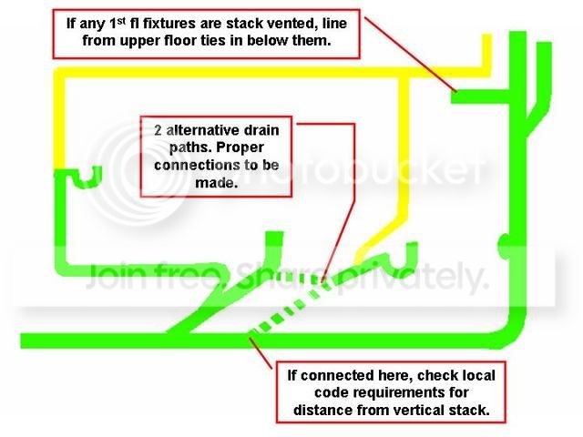

I am by no means any kind of artist as you are, but here is a simple layout that may help. Check your local codes for sizing of your vents. In my area we can vent an entire bathroom with 1 1/2" pipe
The Drawing below shows the wash basin drain and the tub drain wet venting the toilet
Is this ok?
Thanks for the sketch Krow muchos appreciated - is the 3" to the 3rd floor tied in to the 4" stack correctly/position below the kitchen sink? & in turn is the kitchen sink tied in correctly to the 4" stack?
Thanks Krow :)

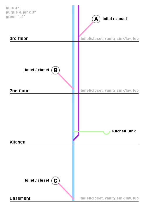

So as i understand: and please correct me if im wrong
1) large discharge of water from above could create positive pressure and push air through a p trap below - resulting in bubbles and poopy smells?
2) large discharge of water from below could create negative pressure (vacuum) and suck air from a p trap above - resulting in siphoning and poopy smells?
please see my little diagram-
Q1) whats stops A and B from having positive and negative pressure on the kitchen sink?
Q2) Will C affect any of the above floors?
thanks novicepiper

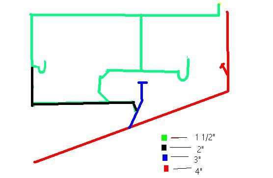

If you do this, you will be in the good books with any Canadian inspector and or Canadian juresdiction. Your sizing of venting and dranage is ok. We generally do not use any 1 1/4" pipe and fittings any more because they are double and triple the money than the 1 1/2". (just a cost factor)
You are allowed to use 1 1/2" for your bathtub drain. 2" is optional. The waste and overflow assembly kit for the bathtub will be 1 1/2" anyway

The sketch Krow made is in line with what I was suggesting. I would however, break out some more slab and run the lav drain more direct with fewer elbows and shorter horizontal runs. Both have effects on reliability. 2" is a minimum Dia. under the slab.
As with anything there are a few different ways of doing it. Below is a sketch of what I was saying. I did not show connection details you seem to have a handle on that. Please excuse my rudimentary drawing... What did your program cost? Where is it available?

can that go up straight up, or does it have to be exactly as in your drawing?
If you can go straight, then do it. It will save you on fittings. The best path from location A to location B, is in a straight line.
Redwood suggested a couple of alternative routes to take, which are just as good. There are many ways to skin a cat lol
Krow
903
Ontario, Canada
If you want to stick with the pic I provided, maybe these slight amendments might suit you better

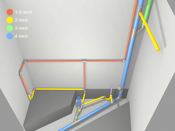

At this juncture, I believe the last image to be complete and final - thanks mainly to Redwood, Krow, Mikey & Jimbo + everyone else too.
If anyone has any questions let me know - once again, a big thanks to you all.
thanks novicepiper
a1) proper venting of the kitchen sink
a2) yes, if the upper floors aren't vented properly.
Here's a simple test I just made up, which a real pro can correct and my feelings won't be hurt: for any fixture, its trap must be vented, and that vent path to open air cannot be affected by anything that can suck or blow. There are special cases (e.g., stack venting) that aren't obvious.
