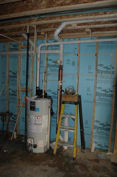

Power-Pipe, It DOES have to feed the cold water side
It DOES have to feed the cold water side of the HW heater AND the cold side of the shower to get the full efficiency out of it. (If it feeds just the hot water heater a 50% unit will only be delivering ~40%, which is still way better efficiency than just feeding the cold side of the shower with it.) With an open crawlspace I'd think the lateral runs of cold to/from the heat exchanger to the tank or to the cold input to the house would be pretty easy to implement, and the cold run to the shower would be pretty close to the drain pipe.
If the cold water input to the house is closer to the shower drain than the hot water heater, just putting the heat exchanger in series with the cold feed to the entire house accomplishes the same thing. (That's how my house is plumbed, with a 4 x 48 DWHX a bit north of 50% efficiency.) Under that configuration the other cold taps would be running other than cold-cold water when someone is taking a shower, but at Portland's relatively cool incoming water temps a ~50% heat exchanger would raise the incoming cold water to the mid to high 70s F in summer when the incoming water temp is highest, and about 70F in winter. When it's 75F indoors cold water stagnating in the distribution plumbing is also in the 70s, which doesn't bother most people. In warm-water areas like Florida it might take it up to an unappealing tepid temp for some people, but not in OR (or MA, where I live.) When another cold water draw is in progress, the output temp of the DWHX drops a bit too- it's something I've measured, but it's never been something anyone in my family has noticed or complained about.
Not having super-cold water out of the tap while someone is in the shower is a fairly small inconvenience to pay for the ability to take showers at half the energy use (or showers twice as long for the same energy use.) But if it's easier to plumb it to serve ONLY the hot water heater and the cold feed to the shower (or just the bathroom with the shower) it won't affect the temp of the cold water in the kitchen.
