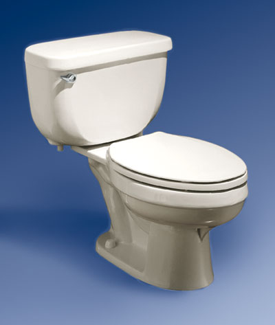

PF/2 Energized Flush
W/C TECHNOLOGY CORPORATION
a MASCO Company
Eljer Aqua-Saver
Parts for this tank
The award-winning
This tank is no longer being made.
Information here

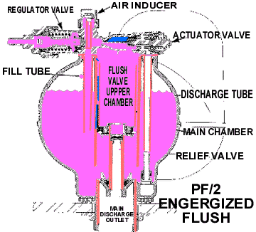

How the PF/2 Energized Flush Works
As discharge demands increase, the advantages of the PF/2 energized system become more and more apparent.
When ready to be flushed, the PF/2's Upper Chamber is completely filled with water. Since water is non-compressible, the speed by which the Upper Chamber can be emptied is controlled by the size of the escape path and the force pushing the water. This regulates how fast the Flush Valve lifts and how quickly the flushometer-tank's Discharge Outlet is opened. Slow opening lets water fill a bowl's internal raceways more gradually than other pressure discharge devices. This prevents the "institutional thud-like sound" often associated with other designs.
When -the PF/2 Energizer flushes, it produces a "flood tide" of water to carry bowl wastes on its crest down the drainline. No water is wasted at the start of finish of the flush.
The PF/2 Energizer uses less than 1.6 gallons (six liters) of water per flush while meeting the highest American, Canadian and Mexican National Standards.
NOTE: 1.6 gallons per flush (GPF) is the same as 6 liters per flush (LPF)
Tripping the flush lever opens the Actuator Valve. This, in turn, opens the Flush Valve's Upper Chamber to the Discharge Tube. Since water under pressure always seeks the path of least resistance, the force from the Main Chamber is able to push the Flush Valve up forcing the water trapped in the Upper Chamber out of the unit through the Discharge Tube. As the Flush Valve lifts, opening the Main Discharge Outlet, the compressed air in the Main Chamber accelerates the water out into the bowl. Extraction occurs.
REFILL, ACTION SEQUENCE
As water is discharged from the Main Chamber, the Actuator Valve automatically resets, closing the Upper Chamber's exit. Refill water from the supply through the Regulator Valve is diverted simultaneously down the Fill Tube and into the Upper Chamber until the Flush Valve is closed. Water flowing down the Fill Tube first refills the toilet bowl, then fills the Main Chamber to energize it for the next flush.
