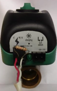

I have a hydronic system with a single zone valve with an air handler in a condo. The 2004 / original actuator head (TACO model ESP075c2-2) wouldn’t close all the way. I spoke with TACO support and they said this is common and the capacitor fails over time and can no longer close.
They no longer make this model, but the replacement is TACO model Z075C2-2. I ordered this unit back in May and it opens and closes all the way.
Unfortunately, the transformer or relay (inside our air handler) makes a clicking sound with the new model when charging the actuator to open the valve. It doesn’t matter if the actuator is on or off the ball valve or hanging in my hand. In other words it is not a friction issue with the ball valve
When I hook up the old unit the clicking sound goes away.
I have been working with TACO support for several weeks. They suggested I add 1000 ohm / .5 watt resistor see picture. This didn’t stop the clicking noise.
Now TACO support is suggesting “If you tried the resistor and the relay is still clicking you may have to wire in a separate transformer to power the zone valve.”
I have tried contacting all of the HVAC companies near me and none of them work on hydronic systems. Just forced air. And I have a feeling that this might also not work.
Does anyone have experience with this? Or have any ideas on how best to resolve?

TACO tech support said: "The capacitors in the zone sentry are larger the the old style actuators, which could result in a larger draw when charging. Is the actuator connected directly to the thermostat and a transformer or is there a control being used? What size transformer is being used?"
My response "No separate control that I can locate. See attached pictures. I also contacted the air handler mfg (First Co) for the transformer specs and they said "Standard transformer 240/24v - 40va"
TACO tech support: "It appears that the power draw on that transformer is right on the hairy edge with everything on that transformer. The resistor may alleviate the issue when the zone valve is charging and the ECO-BEE does draw a lot of power also." and later... "If you tried the resistor and the relay is still clicking you may have to wire in a separate transformer to power the zone valve."
This leads me to believe (likely foolishly) that...
1. My current equipment is not broken (yet) and that the solution involves a different or additional transformer / relay if I want to use the existing actuator valve. I do wish TACO would come out with a revision to their actuator that doesn't draw so much power. Maybe I should try find an hire an HVAC tech to add a transformer?
2. Another possible solution might be to replace the entire valve body with a different actuator mfg (Honeywell?), but they might have similar or different issue. This also requires a water pipe cut. There are shutoff valves so hopefully it won't impact the entire condo building.
3. Or hopefully there is a third and much better (hopefully easier) option that I am not aware of?
Lastly, I believe this issue will affect all of the 70+ units in the condo building and would be good to have a viable (and hopefully simple) solution for all residents.

Until it is known what this clicking noise is it hard to say what the problem is. From pictures the resistor is in parallel to the coil of the actuator. That decreases resistance and increases current. A resistor in series with the load increases resistance and decreases current.
At the relay and transformer assembly, the one relay is to control the fan motor (G wire). The relay will close and open if the voltage drops is too low.
As Reach4 suggest, do get a reading of the voltage across the connection at the actuator for both the old and new. In addition when you try it with the resistor. The new actuator draws .48 amps at 24v AC. Do you know what the existing actuator draws?
