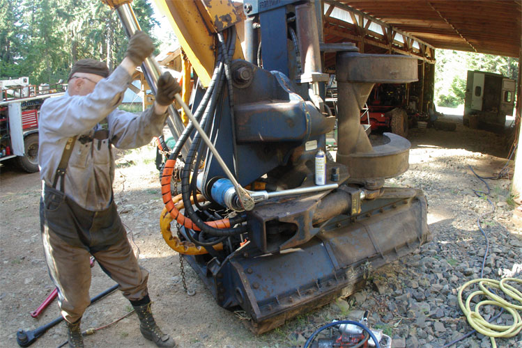

There's also an obscure and expensive tool called a "torque amplifier" that fits on a large socket wrench and, as the name implies, amplifies the torque being applied. You might be able to borrow one from someone who owns and/or works on buses or trucks. I'm told they work well on anode rods. I've used impact wrenches, but always had visions of the glass lining breaking up when I use them.

The torque multiplier still exerts a twisting force. There is a reaction bar that extends from it that could rest on the inlet or outlet pipe... They are used more on heavy equipment than anything else. Still might break something or, round off the nut. There is a reason why they use impact wrenches to put in anodes at the factory... Cause they figured out that it works!
