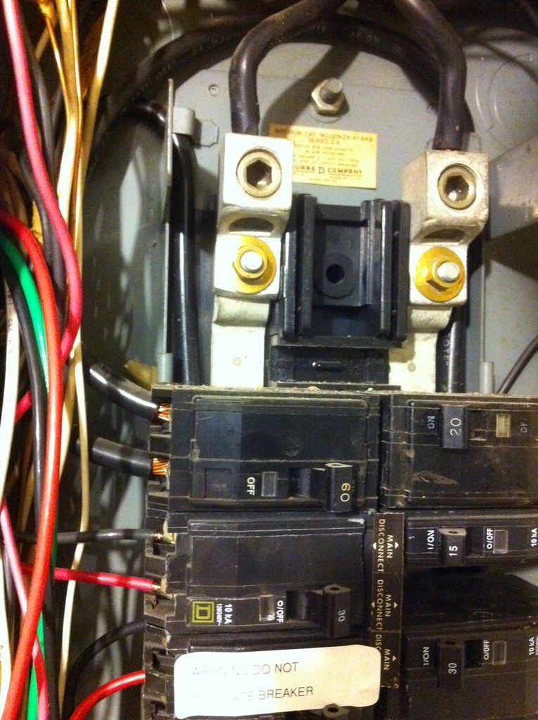

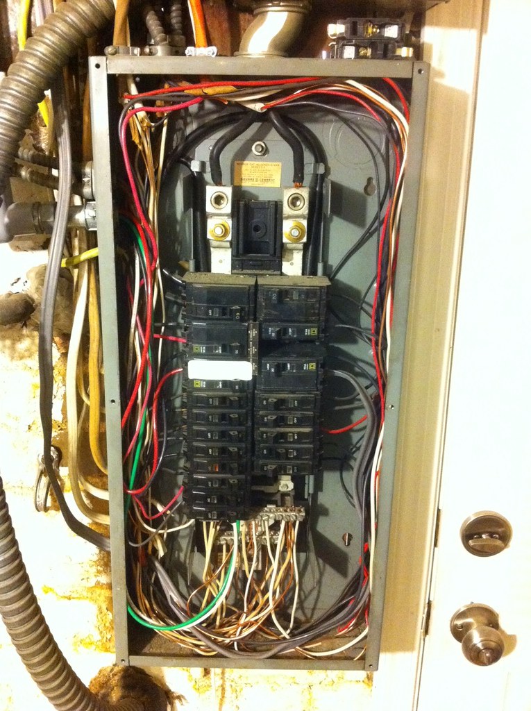

Hey Gang,
I have 240v service coming in from outside. There are three wires--two hot and one neutral. I am not sure what gauge the service wire is.
It comes into the panel and is connected to a 60 amp main breaker. But the wire going into the 60 amp main breaker looks narrower than the wire coming in from the street.
Does that mean that each of the hot wires are 120 V and 30 amps (for 240 V and 60 amps total?).
Or is it calculated some other way? Is the main breaker always sized to the maximum current that the service wires can carry?
By the way, this is a Square D QO breaker box.
Thank you!

The 60 amp breaker is only to shut off power to the lower part of the panel. It is not a main to shut off the whole panel. You can have up to 6 breakers to shut down the power to the panel. The incoming lugs will still be hot.
You can see some labeling in the larger insulated wires going to the topmost terminals in the panel. Tell the size and then someone can tell you what size service you have.

Very interesting...never saw one of those. Is there a main breaker after the meter and before the panel? If there is not than the only way to shut off power to the panel is to pull the meter........

If this is a split buss panel, like several suspect, there is no breaker ahead of this panel.
No, the way to shut off power is to throw the (typically) four or six mains.

Answering the last 2 posts......My house is a 2 family. 1 service, 2 meters. Panle number 1 is just inside from the meter panel outside. Main breaker is inside in the panel.......Panel number 2 is on the other side of the house some 35 feet away. Main breaker for panel number 2 is in a weatherproof enclosure just below the meter pan.......So an outside breaker is not all that rare to me anyway and I believe it was done properly when installed in 1978.And as far as turning the breakers off to de-energize the panel in the split buss panel....yes I am aware of what opening the breakers will do.......I was thinking about being able to de-energize the panel completely.

.......Panel number 2 is on the other side of the house some 35 feet away. Main breaker for panel number 2 is in a weatherproof enclosure just below the meter pan.......So an outside breaker is not all that rare to me ..............
I was referring to requiring an outside disconnect as mandatory. What you have is standard anywhere in the country if the panel is that far into the structure.

Once the wire enters the house there must be a disconnect near the point of entry. This is an NEC code. Your local southwest codes are more stringent.
