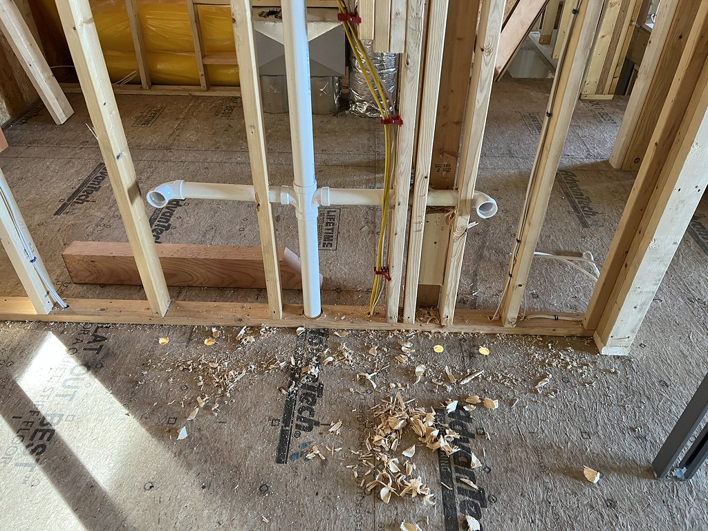

It is good that you have that photo. Yes, your left and right sink should be nicely venting.

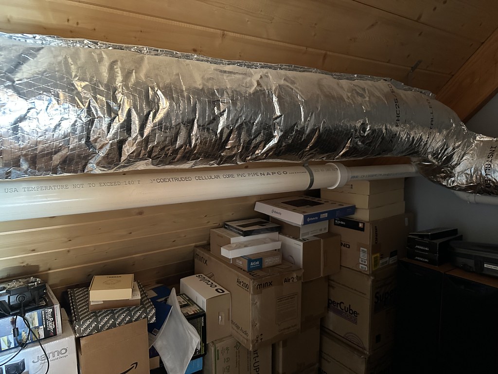

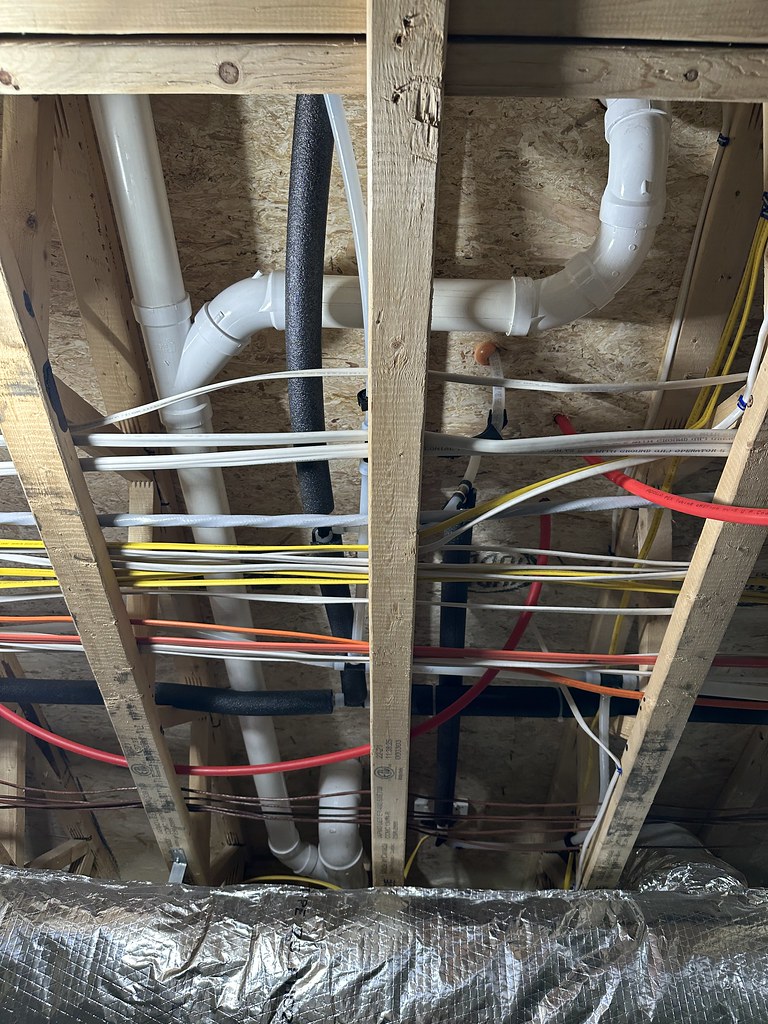

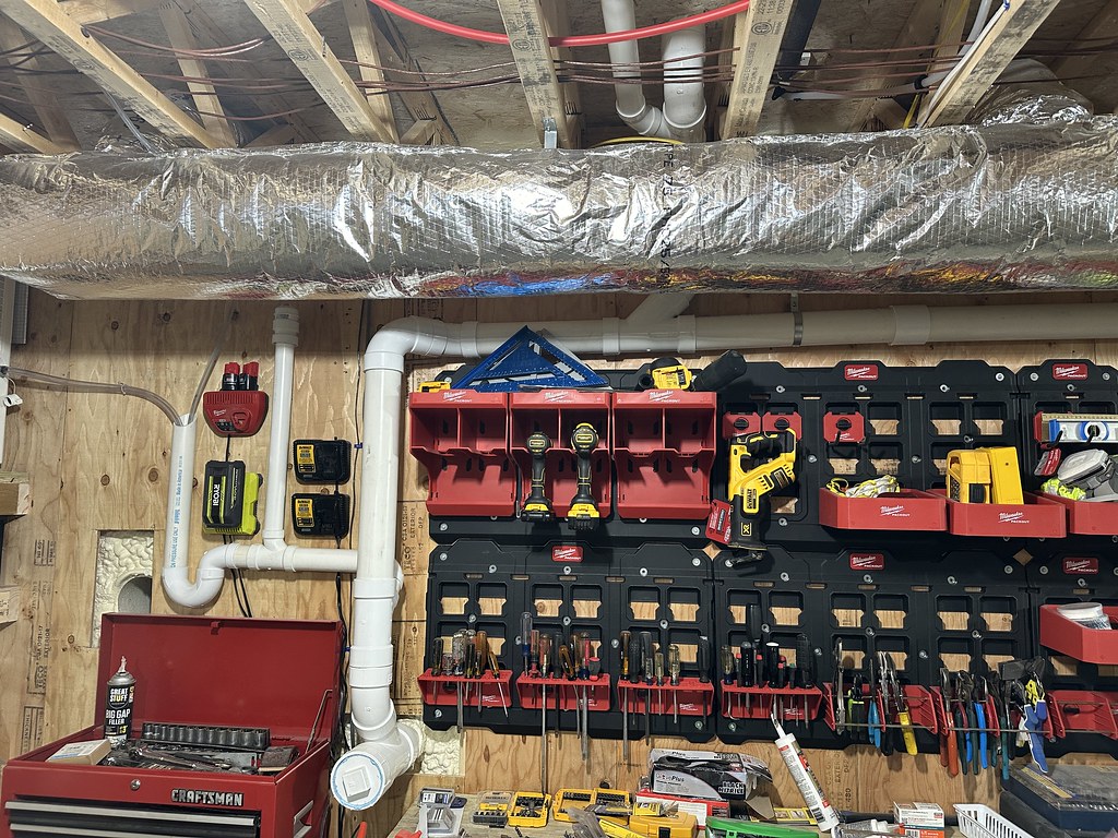

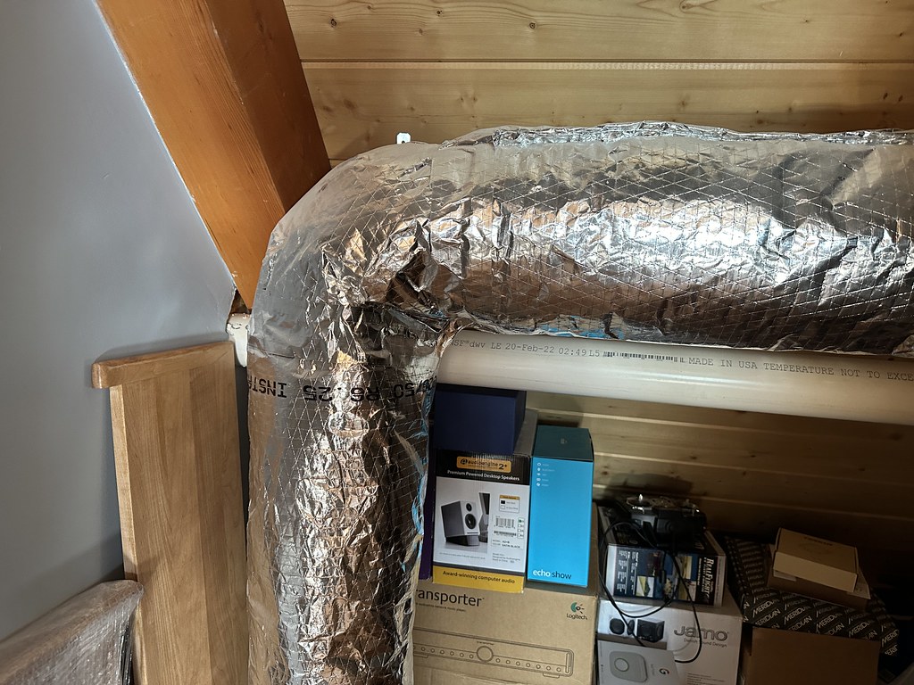

Here are a few more photos
First photo is what the center pipe going down goes to.
So how is the Toilet getting vented? I think the only vent on this whole side is that 2" pipe going up to the closet
Seems like a lot of ups and downs for the Toilet? Sinks are probably ok.
This is directly under those sinks, top right is where that center pipe comes down
Top left is shower from other side of bath. There is a trap in the cellar under the shower.
Does shower vent through all this too?
This is following the line down, you can see toilet coming down in top of photo slightly to the right of center, next to sink drain
This is above those sinks
This is continuing that vent
And this goes out the side of the Dormer

All the DWV in the photos looks like a competent person installed them. However... the main reason colored primer and glue is used is to easily visually see that all the joints are made up properly. Did the DWV get a pressure test with water? Can it be verified that all of these joints are glued together? What caused the flood from one bath to the other?
Just because a sink is brand new doesn't mean something can't stink in its overflow. It can't hurt to perform a test to eliminate it as a possibility. Its more likely that than air bubbling backwards up the trap when water is flowing downstream. We install thousands of traps on sinks each year and never have anyone complain about smells coming up from them. But we do get that issue from overflows on this site from time to time...
