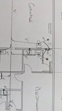

Hey guys....wondering if somebody can help me out with some DWV stuff. My shower is at the end of my bathroom and I'm wondering if I can vent the entire bathroom off the shower? I guess that would be wet venting the bathroom but I've only seen it done through the lav. Thanks for any info you can provide.

No.
Every trap needs a vent at the elevation of the trap (before the trap arm has fallen one pipe diameter). And with wet venting in a bathroom, you can use a fixture's drain to wet vent a downstream fixture. But there's no way to use the shower's drain to wet vent a lav trap, the drain is just too low.
So that means the lav always needs a dry vent, as its trap is the highest in the bathroom. That's why you see the lav being used to wet vent everything.
You can still dry vent the shower and use it to wet vent the WC. You'll just need to dry vent the lav as well. Those dry vents can combine at any elevation at least 6" above both fixture flood rims.
Cheers, Wayne

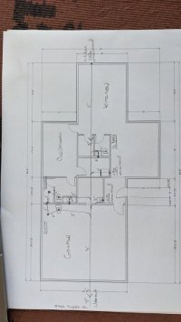

Not sure how clear my drawing is so I figured I'd answer your questions. Main 3" drain runs basically down the center of the building to pick up the half bath, washer and utility sink on the bottom and the full bath and possible second full bath above. Kitchen is on the far end of the building and is just one 2" sink line/vent.
So yes, just mirror the bathroom for DWV rough in.
The wall between the WC and shower is not solid so the vent would have to be either in the garage wall or the wall into the bedroom.
Thanks Wayne, you've always been such a big help
This is how I would assume it has to be done. Two separate shower drain/vents and two separate 3" branch lines down to the main. If there is a way to simplify it and get rid of one of the separate 3" branch lines that would be great. I think that would be pretty simple with a crawlspace but I'm struggling to think of what fittings I could use to do that horizontally under slab since I don't have much vertical space to stack fittings.

The main problem with your drawing is that you have a horizontal shower dry vent under the slab. Dry vents can't go horizontal until at least 6" above the fixture flood rim, so that's not allowable. You'd need to route the shower trap arm itself to under or near the wall, so that the dry vent takeoff can be vertical. Vertical includes up to 45 degrees off plumb, so you can use a combo with the barrel rolled up to 45 degrees.
Can I interest you in either a trench drain under the showerhead, or a short section of solid wall (8" - 12" long) between the WC and shower? Either of those would make the shower venting easier. But I'll try to draw up something with a center shower drain and no solid wall.
Also, per breplum's advice, I've never done underslab DWV, just in a crawlspace. So I may not be the best advisor.
Cheers, Wayne

So maybe something like the drawing below, except that it doesn't show any cleanouts, and adding cleanouts might require rerouting some of the drains. I'm not so familiar with the cleanout rules.
Green is 2" and red is 3". Each shower needs a 2" dry vent so that it can wet vent a WC. A drain for two lavs needs to be 2", although the vent above only needs to be 1.5" (i.e. you could use a 2x1.5x1.5x1.5 double fixture fitting in the wall).
Also, each shower trap arm is limited to 60" of length and 2" of fall before the dry vent comes off. I tried to draw each one so that at the wall you'd use a 45 plus a 22.5 to turn parallel to the wet wall. But maybe it would be better to have one of them start off perpendicular to the wet wall and use a LT90 to turn parallel to the wall.
As I mentioned before, each shower vent takeoff would be a 2" combo with the barrel horizontal (2% slope), and the barrel rolled so that the side entry (dry vent) comes off at 45 degrees from plumb. Then a 45 to turn plumb once under the wall.
