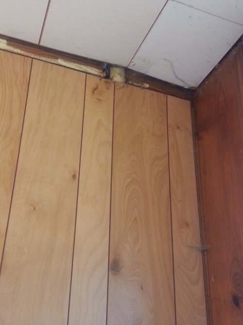

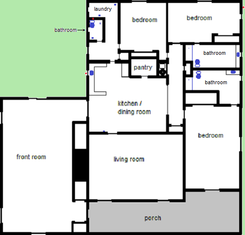

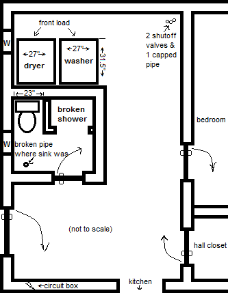

I will probably have to provide diagrams at some point but basically on the southeast end of my kitchen there is a doorway (with a curtain rather than door) that has a door out to the back on the left and a bathroom on the left side with the door parallel to the kitchen doorway. The hallway itself goes to the south exterior wall and on the left (east) it has a tiny laundry room. Well, it might be decent sized but the washer and dryer are on the north wall and they are 31.5" deep. Each one is 27" wide. One cannot walk through the room if the doors to either are open. I think the total width of the wall that the appliances are against is about 60" or less. The installers tore the linoleum (which was sitting on top of a damaged floor that the linoleum installer tried to fix by pouring in some white powder and adding water). There's apparently a moisture barrier underneath because I can see clear plastic. The linoleum installer had apprentices doing the job and they used the wrong length so there is a seam across the middle of the floor which has started to come apart. (The installer has since retired from the rug business and currently drives a school bus).
Here is a rough sketch of the bathroom (nothing is really proportionate and I need to do more measurements).

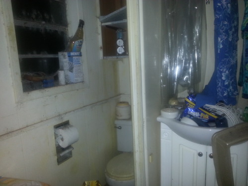

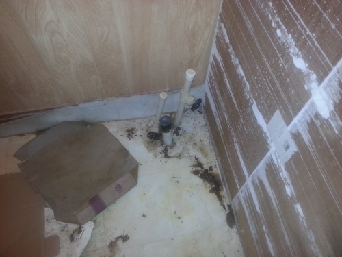

There is a metal pipe coming out of the floor that the wall-mounted sink used to attach to, but the sink fell off the wall and the pipe broke. I don't think it is currently attached to anything. In the laundry room there are three plastic pipes sticking out of the floor. Two of them have shutoff valves and one of them is capped. The east wall has a small window in the laundry room. There is also a small window in the bathroom. There is a small ceiling fan in the laundry room as well as a vent to the central air conditioning.
I don't think that the wall the appliances rest against is load bearing.
I'm thinking of tearing out the walls of the bathroom, getting rid of the useless shower (which is currently being used as a storage closet), moving the washer and dryer to the east wall or south wall, putting in a sink to rinse clothes in and having a stall for a toilet using either a shower curtain for a doorway or a bifold door or an accordion door. I don't think there is enough room to have a sink and toilet in the same little room and still have decent space for the laundry area. Given the market for houses in this area, we aren't terribly concerned with losing value in the home by eliminating a bathroom. The current bathroom is not anywhere near up to code anyway. I wish I could figure out how to keep a small shower in the area somehow too. Perhaps it could be used to rinse with a detachable shower head or something-- but again, more walls= less space.

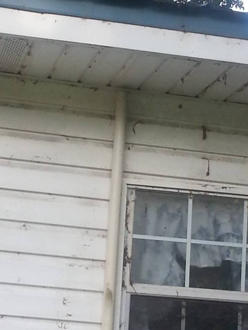

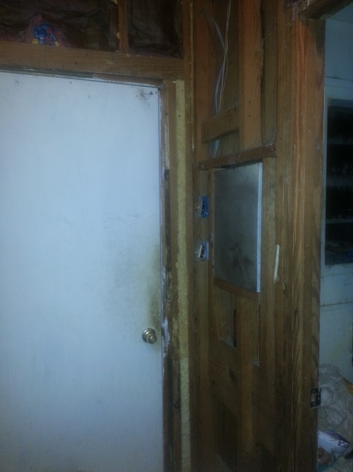

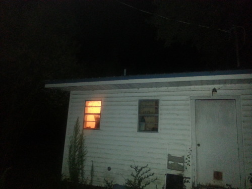

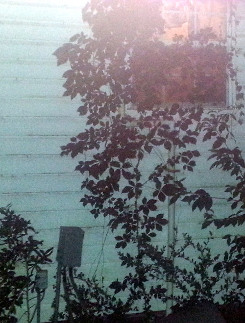

There is a light above the exterior door (the wiring is inside but the light is for the outside). We currently have a curtain hanging in the doorway to the kitchen because the entire laundry area is not properly insulated and is cold in winter and hot in summer. The wooden floor near the door got wet somehow and expanded we tried putting those styrofoam wrapped in cloth things under the door but it just snagged on the linoleum and tore it and then ended up getting stuck and making it hard to open and close the door.
The bedroom has two entrances (one to the laundry hallway and the other to another hallway on the opposite side). I once entertained the idea of having the bathroom on the south wall and moving the bedroom door closer so that room would have its own bathroom. Unfortunately the room is so small that with the position of the bed that isn't feasible (because of interior closets and other things there isn't any space to move the bed elsewhere). We are entertaining the idea of getting rid of the east door to the bedroom as the north door is the one being used.
I will try to get more measurements and such and maybe even some photos.
I plan to do as much of the demolition as I can by myself (perhaps with the help of a friend who has offered to help if I need bc we helped him out).
I'm hoping to do this as cheaply as possible.
Any suggestions thus far?
The kitchen currently has parkay flooring so there is a drop to the linoleum. The entire area used to be parkay flooring but the tenants destroyed the floor in the laundry and bathroom.
What type of flooring is very durable/sturdy and water resistant but not too pricey? It needs to be able to handle heavy things being dropped and appliances being dragged. I know the floor underneath is not level.
Any pictures or drawings of layout suggestions?
Should I try to keep a shower there or does it seem there isn't enough space?
What would be the best use of that space?
Thanks in advance for any suggestions.

The immediate solution would be to rotate the W&D so they are on the west, ( or east depending whether North is up or down), wall and you have better access to their doors. If the room is 60" wide, which would be normal, that is how they intended them to be installed, except maybe for a poor plumbing design.
1,193
FWIW, the toilet installation does not meet current code which requires a MINIMUM of 15" either side of the center for a toilet install. Where you have a toilet, you must have a sink nearby to meet code, too. Now, a laundry sink may qualify - you'd have to check with the local inspector. Many washer/dryer pairs have optional stacking brackets, which may help with the space problem. I agree with HJ, I'd consider moving them to the west wall - they should fit with a little room to spare. In most cases, the WM hose is long enough, but the dryer duct may be more of an issue, but not insurmountable.

Thank you for the replies. I should have flipped the drawing but I drew it as I see it when I face it sort of. Up is South, left is East, etc.

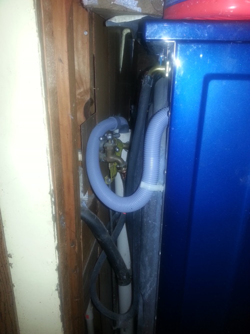

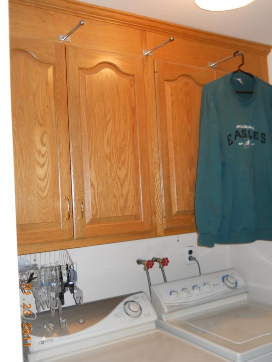

I have this washer and dryer set (complete with pedestals)
But they don't sit so closely together.
The plumbing to supply water for the washer and dryer is on the north (lower) wall and sticks out about 5 inches. This makes the washer and dryer stick out even more. The combined width of washer and dryer of pushed tight together would be about 54". The east (left) wall has the window (which is slightly below the height of the washer/dryer) and the vent for the dryer is also on that wall. IIRC, my mother said that the reason she didn't want both units on that wall was bc there was no room to open the doors since the wall is a little less than 61". The doors are rather thick and won't swing very far (because of the stuff on the South wall that sticks out and makes things have to bump over more to the North wall by 4" to 5"). Just moving the washer and dryer in to the space in the first place was a major ordeal in the first place.

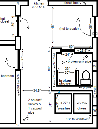

I have a revised sketch with some rough measurements. It was hard for me to get in to some of the places to try to see and I had to have my brother tell me what he thought the measurement was on some things when I was holding the other end. He's even worse with measuring tapes than I am. I have a hard time seeing the little lines. LOL.

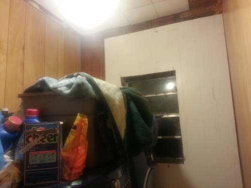

Just before the entrance to the actual laundry area is a door frame. I've determined that the wall is not load bearing (one since it is so small and two because it runs parallel to the joists- the load-bearing beam in the kitchen is perpendicular to it).
From the South wall to the window = 18". The window is just shy of 23" wide.
Hopefully the rest of the measurements are legible. I was obviously terrible at getting the proportions done right. I should find the right software. I just slapped it together in MS Paint.

My washer and dryer is the exact one shown in your picture, including the color. The doors only have to open 90 degrees so the wall is not a problem.

Other notes: The window in the laundry room is just under 23"wide and is 18" from the south wall. The bathroom has no lighting and is being used as a storage closet so I didn't get the window measurement there. That window in particular is home to spiders. The whole room is probably a spider nest by now actually. The measurements are approximate since I am not very handy with a measuring tape and I have trouble seeing the smaller lines. If it isn't .25 or .5 or right on the mark of a main number I have trouble seeing it.

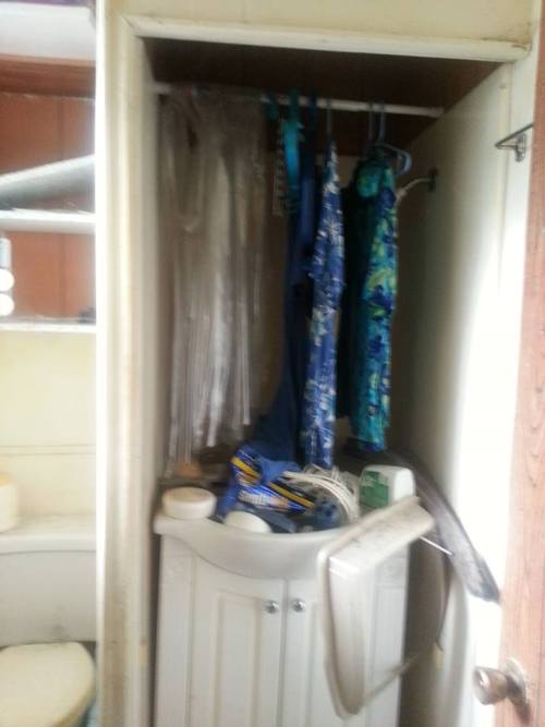

The vanity/sink is like this:
but will have a higher faucet-- I wish I could find one with a spray attachment that wouldn't be expensive.

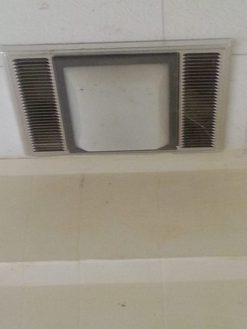

* An electric vent that removes moisture from the air so the room does not become too damp (I think current bathroom has vent-lite-heat thingy but am not certain).

I have some ideas but first, a few things.
There is a lot of space wasted between the door from the bedroom and the washer. In order to maximize the space and get everything you want, you'll need to change things right around. This means relocating plumbing and electrical, which puts cheap right out the window. Your plan didn't show where the plumbing stack is nor what kind of access you have from underneath (is this on a concrete slab? a crawlspace?), so I just drew up some floor plans to at least give you some ideas.
Based on your measurements, this is your current floor plan:

This gives you a bathroom and a place to fold laundry, but no laundry sink.

This plan would require you to use the top of the washer and dryer to create space to fold laundry. Maybe you could put the litter box under the laundry sink.

This would give you everything you want except now there is no direct access from the bedroom on the left.

It won't let me edit my first post so just let me add that my plans assume that you can remove the walls that enclose the bathroom but it is up to you to find out if that is the case.

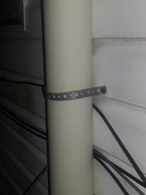

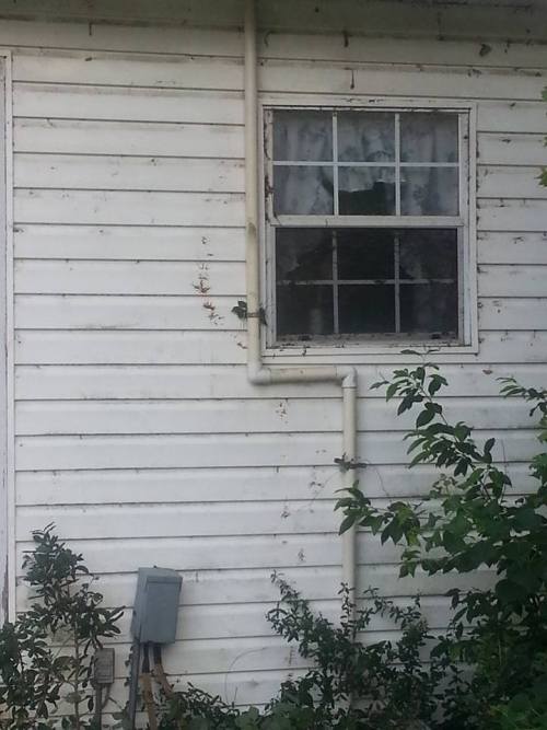

The sewage plumbing all heads West toward the septic tank. I would have to take a look underneath to try to figure out the current configuration. I'm willing to bet that it is not to code (in fact, I think the plumber actually mentioned that the last time he had to fix something but he said it would require some extensive crawling under the house to get the job done). IIRC, he pretty much said the entire plumbing job under the house had been f-ed up by the tenants (I don't know why they messed with the plumbing, but they did) and that it all needed to be redone "eventually".
Something keeps clogging up in a spot in winter and he has to come out at least once a year to clear it so we do need to have it fixed eventually.
I need to figure out what that clear glue is that can be put on even when stuff is wet and that allows the water to be turned on within a couple of minutes after being applied. The pump guy uses that stuff.

No problem, I have fun coming up with with these layouts. I'm an amateur but I've spent a lot of time planning out my own project.
I came up with a new layout based around keeping the toilet in the same place, but turning it around. It also shows the existing walls so it makes it easier to picture. Let me know what you think.

That one looks like a possibility. It would make the laundry easier to reach without having to squeeze through the hallway while carrying a basket. We could probably even open the back door to shake things out if they have a lot of dirt on them with that layout.
Now that I look at it I'm not sure on the corner shower. Although I suppose the empty corner could have some sort of storage

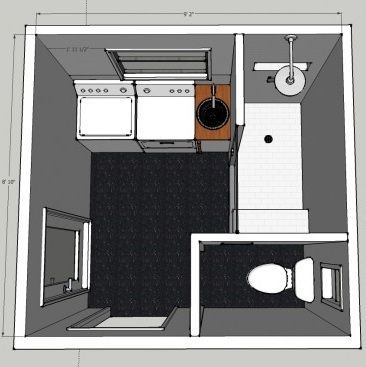

I was somewhat inspired by this picture even though I know it wouldn't work for my space given door/window placements.
I liked the toilet stall with the window.

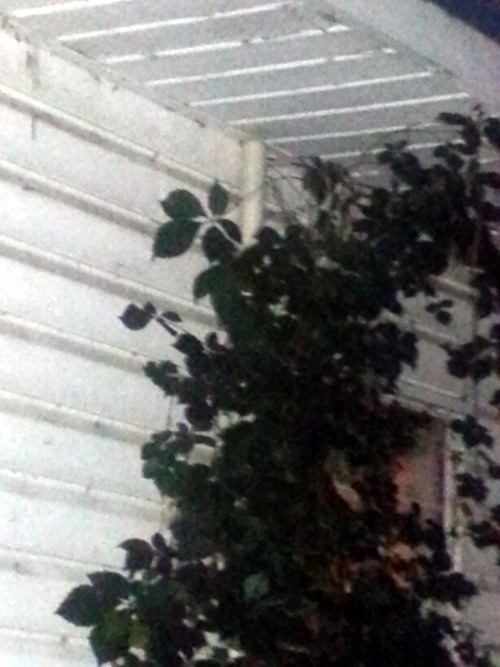

Update: I took photos of the vent pipes but they didn't turn out well because of vines growing. I located a total of three vent pipes. Two were small ones (I'll have to try to measure to see just how small) and one looked to be about 4 inches.
The first smaller one was coming out from under the kitchen sink to the east wall directly under the window. It made a 90 degree turn to go around the window and then went straight up to the roof where it just stopped (nearly touching the soffit).
Here are crappy photos of the vent pipe near the kitchen sink.
Here is a shot of the roof vent pipe (also a bad quality pic)
Here is the largest pipe and how it ends (it comes out from the west side of the house just north of the window to the northwest bedroom)
Another shot of the larger vent pipe.

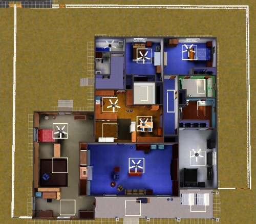

Here is a rough floor plan I sketched of the house. Blue marks the bathtubs, toilets, and sinks. There are two bathroom sinks and a kitchen sink as well as three toilets and two bath tubs. I do not know where or if the useless bathroom's sink and shower are tied in or not.
I somehow suspect the house is not vented properly. At least we have vents now. When we came back from overseas the tenants had ripped out all of the vents and screwed up our water lines.
Out of curiosity, what would be the proper sizes, order, and distances for these vent pipes? Is it normal to have so few and of such small size?

This is a shot of the back door and the wall to the bathroom (the square metal thing is the back side of an inset medicine cabinet)
Here is a shot of the bathroom from the doorway. The vanity is currently sitting inside the shower.
Here are the shutoff valves and the cut off pipe (which has electrical tape over it) in the southwest corner of the laundry room (the cardboard is covering floor damage) Is it possible that it was the hookup for a laundry sink at some point? I'm thinking one was hot water, one cold, and the other was the drain?
This shows the plumbing and junk behind the washer and dryer

Just for fun here is a mock up I made of my house in Sims 3. Ignore the white squares-- they are lighting things for the game to make things visible.

I don't know what to say, really. I can't imagine why the vents would ever need to be run on the outside of the house in a single-story building. Without knowing what your abilities are and more specifics on what changes you are making to the layout, I can't really add anything else. At some point you have to make decisions.

I've since been told for certain that the vent ending under the soffit is not to code.

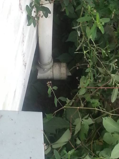

Here is a better picture (I pulled the poison oak vines off of it):
Here is a better shot of how it goes around the window:
It has a cleanout at the end-- the pipe came apart and I need to glue it back together underneath the house. The horizontal turn is less than 6" above the sink.
This is the antique vent/light/heater just in front of the shower.
This is the vanity sitting inside the shower
This is the laundry room vent pipe that goes up into the attic and through the roof.
