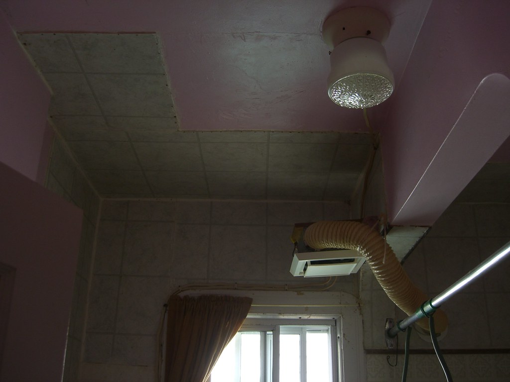

Test - can you spot a code violation?

Poster on another site wants to sell his house but figured he should fix possible problems 1st
http://farm3.static.flickr.com/2632/3792392595_ea266b3c85_b.jpg

Is there a switch for that exhaust fan in the shower stall? I would really hate to have to get out of the shower just to turn the fan on or off.

Nice...that fan must be saving them $$$ it looks like it is running on 220 v with the 2 circuts running to it and I realy like the innovation of using the overhead light to support the exaust tube...they just need a switch hanging from the ceiling on SO cord to to finish it off right by make things real accessable..

BUT.....this bathroom....most buyers would take a look and that and assume that even WORSE problems are hidden throughout the house!

Personally, I like the fake tile look.

...also known as flooring that has been applied to the wall presumably so that the cable clamps could be more easily nailed to it.
It's so depressing to see an extractor fan like this in an otherwise once-perfectly code-compliant bathroom with a window that can be opened.

They were having a problem with mold
So rather then paint with mildew/mold resistance or tile "Dad" put up the tile
It's glued & nailed in place
He's pulling it off & just patching up the sheetrock
Fan will be removed
I think the wire coming from the light feeds the fan via a switch on the side
So only 1 wire to the fan, but looks like 2
Of course it would have been easier to just run power to the fan from the light & have a switched hot
But if you're going to muck it up might as well muck it up real good
Who needs a fan in the ceiling??
