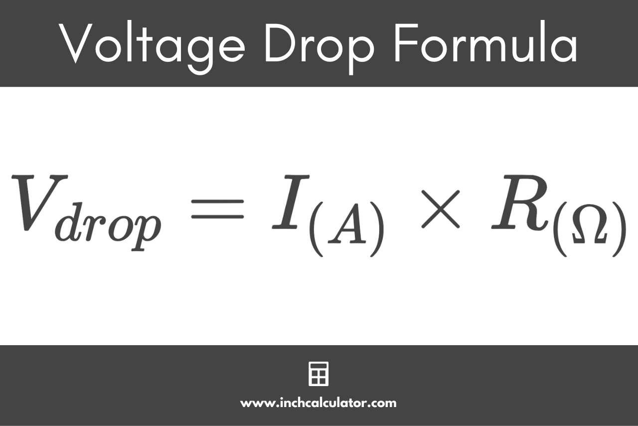

Specs read 35 amps 220 vac
8 gauge copper 85' wire
10 k gallons of water = weight 84,300 lbs
To raise the water temp 1° takes 84,300 btu's not figuring in any temp lost.
wwhitney
6,567
1,847
Berkeley, CA
Not sure where 85' came from?
As to the current to use for voltage drop calculations, 35A is the maximum overcurrent protective device. The circuit should never see that much current other than during starting, so that's an excessively conservative number to use. The minimum circuit ampacity of 22A is more reasonable, although that it likely still quite conservative.
