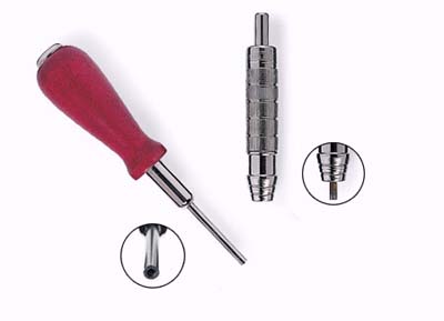

Hi, I use to do alot of plumbing work but was given this tool and all the supplies when i worked fulltime plumbing. I lost the tool in the mean time and have looked everywhere on the internet and at multiple stores for this tool.
The tool was red and the purpose of the tool was to assist in driving a nail into the concrete block wall. the tool had a rubber grip like a chisel has. And had a shaft inside it that you would strike and drive the nail into the wall. The nails were short and had a metal washer close to the pointy part of the nail. We called the nails.... drypins. But that must not be the real name because i can't find the nails either.
I would use the tool and concrete nails when securing copper water lines with 1/2 or 3/4 straps.
if anyone knows what the tool is called or where I may buy one please reply to the thread.

Sounds almost like a gutter driver.
or maybe this
Google "nail driver" and then go to images.
Is this similar to the nail?
The one I used was similar, but the tool was more cone shaped with a protective lip at the top and a bigger head since you need to beat on it much harder to get a hardened nail into concrete. The nails are usually much shorter with a slightly longer point. The washer fit into a recess in the tool to help hold it centered underneath the ram pin.

jadnashua. The tool you are describing is exactly what i am talking about. do you have any idea where i can find one... or what company that makes it?... floridaorange.. that is not it.. but thankyou for doing some research.

hj... Nice find.. I don't know how you found the tool on the internet.. But that is aweosme. Thank you very much for finding it.
