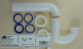

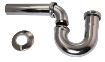

Guys my OP is about the J-Bend outlet connections types, bead and ground joint, both types are available in plastic and metal J-bends.

You are correct LA, NY, WA... have these requirements but those connections are made at the trap arm/elbow outlet. The connections I am pointing out are on the J-bend.
Evidently traps are manufactured to meet the particular requirements of a design spec and to meet code. What could possibly support these seemingly redudant joints.

Only you have really answered, with a single word and then followed with a paragraph unrelated to my question which is OK, I like all posts and points of view, they are interesting. Anyway I still hope to find supporting info as to why these two connections are available if the diferentiation of using them is not code driven.
