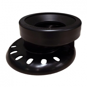

I am installing a new toilet, and the hole is in concrete surrounded by marble -- so no chance of moving it. That said, the toilet is too close to the shower and needs to move to the side 1-2 inches.
Options? Can't do demolition to the floor....so is there a brand\model of toilet or offset flange that allows some lateral movement? (or perhaps even a smaller oblong toilet that will help with space?)

There is at least one Caroma toilet that can offset 1 inch in any direction from an 11 inch rough. Caroma Brisbane 270 is one, and there may be more. That is a possibility. https://dynastybath.com/product/caroma-off-set-flange-connector-10-12/
Concrete and even marble can be cut to install a new flange. Some offset flanges offset by 1.5 inches. You would need a toilet where the skirt will cover where the marble has been cut.
