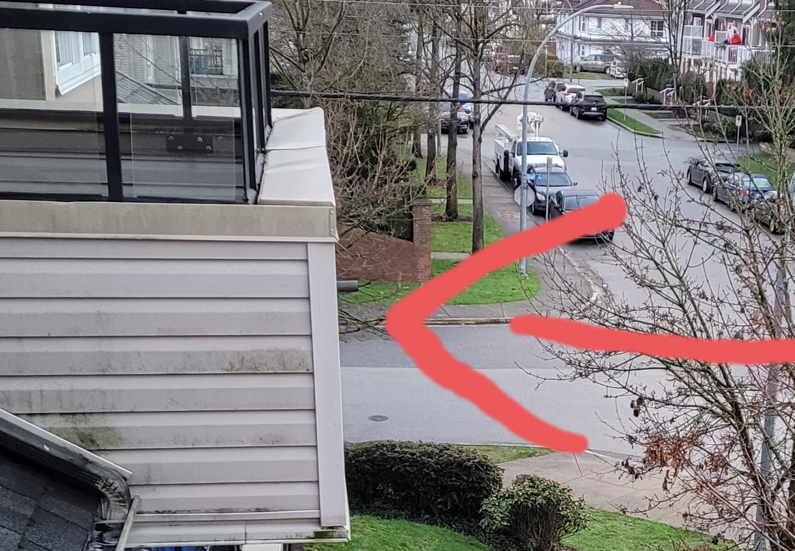

Hi all,
After a heat wave from hell and going back and forth with my condo, I finally got approved to install a mini split in my condo. But after talking to many contractors and an engineer (my compromise was getting an engineer to help quell the condo board's concerns RE: envelope penetration for the linesets, and also for drainage), I have learned draining isn't as straightforward as I thought.
Condo board's concern is they don't want the condensate dripping on the patio constantly which they think will leak below. Ironically, it rains a ton here (about 192 days per year), but that's neither here nor there. So I have to find a way to rid the condensate when both in heating, and cooling mode.
Cooling mode, most contractors who gave me estimates want to do gravity drain outside. Some have said to tie in the condensate line to my patio floor drain. My engineer seems apprehensive to sign off on that as he thinks the condensate's acidity could pose a problem with the patio membrane. I have heard very conflicting information about this, whether it's just water or whether it is acidic. Patio is stone tiles with gaps and a floor drain. I thought that the floor drain would go directly down to the storm drain, but there are these metal pipes protruding from the sides of the balcony, which make me believe it may drain outwards?
If not, what are those horizontal pipes jutting out from the balcony for?
This is what my storm drain looks like
That's on the patio. Some contractors want to tie the condensate gravity drain into that, but the concern is the condensate dripping where it shouldn't. I mean, rain does get on there but not at the same rate as condensate.
The other option is to tie a drain line to the side of the gutter, and drain it directly into the gutter
Or, run condensate pumps and tie it into the laundry line. That would require pumps with surface mounted drain lines running about 30 feet through my condo. Aesthetically won't look amazing. My big concern is leaking on my walls if the pump dies which I do hear they do.
Final option would be to just have a removeable bucket on the patio and drain the condensate into that, and just empty that daily. The most archaic but I just want AC this summer.

Condensate from a heat pump isn't acidic either from the inside unit or from the condensing unit going into defrost mode. Might need a drain from the condensing unit for defrost mode ask your contractor. Condensate from a gas fire burner from a hi efficiency boiler or furnace is acidic from the property of combustion. Pour a bucket of water down the patio drain see if the comes.out the pipe ( bet it will). Condensate pumps should have a overflow switch if they die shuts off unit.

Roof scuppers, for overflow might have a separate one that runs down to ground or to storm drain.
Often there is a drain and a overflow

Thank you for the replies. I am pouring water down the drain and don't see it coming out the pipe. How can I tell if it's an overflow or the direct drain? It does rain a ton here but rain is of course at a much slower flow than condensate.
