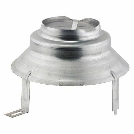

Hello,
Please tell me if this WH is vented correctly.

NOT at all correct. Some idiot removed the "draft hood", which is critical for creating the draft necessary to carry the deadly carbon monoxide (CO) out of the unit.
It will take some challenging work to tear out all that you have at the furnace to make it right.
ALSO, the PVC A/C condensate line must be trapped and filled with water to prevent the furnace from blowing conditioned air out into the room.
Please make sure you have properly placed CO monitors in the house.

There shouldn't be any Co blowing out the condensate. If your city or state code requires a trap it needs one but if not a trap is only needed if the ac coil is on the suction side of the blower. Take another pic or two of the flue pipe either going into a chimney or vertical pipe. Very surprised without the drafthood water heater hasn't had burner problems. Here's what a hood looks like.

I would expect that condensate should be 6 inches from a s/w vent connector . shouldnt be c/o blowing through your system even if the condesate was trapped it would still be blowing all through the house.
Of cource major issue that w/h vent not having a vent hood
