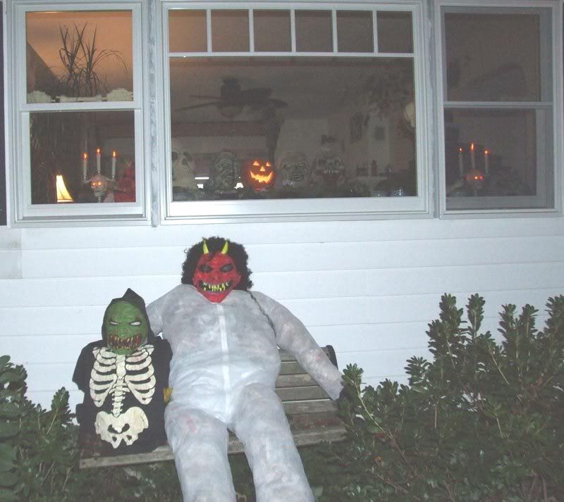

More light - I like windows. The new picture window in the main room made a big difference
There is a whole look & style to a Craftsmen house
I would be inclined to insulate the walls 1st, then worry about the windows. If insulating the walls means taking the siding off, then I would look very closely at the cost/look of new windows that would match the style of your house (then decide)
As Frenchie said, its the cold air blowing in that will be the biggest problem. I had a bathroom fan vent that the outside damper was broken. You could feel a cold breeze coming in when the wind came from the East. If your windows are tight around the frame & sill then you are in pretty good shape. I don't have any grilles as I can't stand the "fake" grille look
The picture window is the only window with a grille in our house - non removeable. It also has the smaller windows divided "in the glass", seems like each one is a seperate little window
