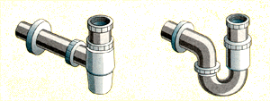

saw these devices on a recent trip to Europe. They call them "Siphon" ... they look much better that p-traps and are much shorter. Are they available (and legal) here?

I doubt any of these would pass code, which is not to say they aren't any good. US regulatory agencies are generally not the most flexible, forward-looking, innovative, etc., organizations in the world. For example, when I imported a European car a while back, I had to remove the yellow turn signals, since the US required red. Now, of course, the US requires yellow, and I don't want to talk about headlights. If you were to sneak one of those fancy traps into the US in your luggage, it would probably work great, and (eventually) pass code. Of course, if you got caught, you'd probably wind up with an all-expenses-paid vacation in lovely Gitmo.

The two left ones are bottle traps and the chrome one is sold by many pedestal sink distributors. Technically they are illegal because they depend on internal baffles for the sealing, and those baffles cannot be easily tested or checked for failure or poor manufacture. The design also limits the area of the water flow passage. The right one on the inlet to the trap must just act as a flow restrictor since I cannot see any other purpose for it. But in all three cases it is not a substitute for a "P" trap, it is either a different version of a "P" trap, or an addition to one. Do not go "Continental" on us and start thinking that just because it comes from Germany or elsewhere over there, that is it far superior to what we have. If we turned the codes over to the contractors and engineers, we would probably have those things also, and a lot of other questionable shortcuts to save construction costs.

I can't see what the chrome jobby on the right has that the $1.59 plastic traps I use don't have. I hate chrome for many reasons. Is there some kind of magic in the white barrel-like piece in the input arm?

The only problem you might have with getting a 2" trap in a 2x6 bay, using these, would be that they probably only come in 1 1/4" and 1 1/2" patterns.

The water flow in the top square one would be turbulent and would be more likely to plug up with hair and other objects.
I think the P-trap is still much better even if you use smaller pipe. Why use large pipe in the trap section if the popup sink drain only has an effective pipe size of 3/4 inch?
The P-trap is also better when you are trying to unclog it.
