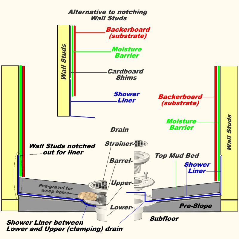

I found an image on floorelf.com that I think is an accurate representation of what should happen.
If the picture above is acruate, then I goofed up on installing the drain, and it should have sat higher so the preslope could go under it slightly. It would in this instance go:
  1. pre-slope
  2. liner
  3. top mud bed
  4. vapor barrier that would be over the liner, and would drip onto the mud bed.
I'm going to have to get in touch with the marble guys and see if I can get more details from them on what they do. I was going to higher them to do basically, the pre-slope, liner, mud bed, and marble panels. But depending on what they say, I may have to rip out a lot of work to remove the drain (there was no wiggle room to begin with, so if I have to cut it out, this is going to become a whole new project!).
If the marble panels are being set similar to a big tile, then yes, you have your drain at the wrong height. And, keep in mind, as I said, the waterproof liner is REQUIRED to go at least 2" above the top of the curb AND pass a leak test. What you have shown is a conventional shower construction.

Preslope, liner, setting bed, finished surface (regardless of what it is made of), is a conventional shower!
Plumbing code and industry standards call for the liner to be flood tested, and extend 2" above the top of the curb. So, the normal way to construct this is install the preslope, then the liner, then the vapor barriers on the wall, then the cbu on the wall (no fasteners lower than that 2" above the top of the curb, which means it can flop around!), then, the setting bed is installed which locks the bottom edge of the cbu in place. Then, you can install your panels. Once the preslope is in and you've installed the liner, you perform a flood test. IT should NOT leak anything!
Note, there are a bunch of products called cbu or cement board. The procedure differs slightly depending on the class. There are two, those that are essentially cement based, and those called fiber-cement based (HardieBacker is a fiber-cement board). A cement based one can be buried in the setting bed, a fiber cement one CANNOT, and thus, since you can't screw the bottom edge in place, can be problematic since there can be NO fasteners below the 2" above the curb. One of the biggest mistakes people make is driving screws through the liner into the curb (often to install cbu there, which is NOT the way it should be done!)...there should be NO holes, and it takes a bit of skill to get the curb so that you can install something on it where it is stable and mortar will stick (it will NOT stick to the liner!).
Unless the cultured marble pan is one-piece and has a curb and lip all around it with built-in slope designed to attach to a drain, thus making that assembly waterproof on its own, you need to build your shower as if it were going to be tiled, and when you talk about a preslope, that precludes installing what you're talking about unless the setting bed is installed flat. That is likely to make the 3-piece clamping drain too short to fit - the top part only extends so far.
Normally, if the pan is preformed with its own slope in it, it is designed to be installed with a different kind of drain assembly that is either clamped to the pan and attached with a nut and big gasket, or something similar. That would have NO weep holes, which is a characteristic of a clamping drain and a tiled shower pan. Now, if what you've planned has passed plumbing certifications doing it another way, fine, but you'd really want to see and verify the instructions before you proceed with generic instructions. IOW, you really need the instructions for the pan you are having installed as to what the prep work is required, and exactly how to install it.
