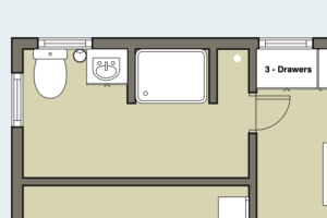

Upon discovering that busting out the concrete around the first drain wasn't so bad (thanks in large part to advice found here), I'm considering the pros and cons of trying to rearrange things a little - the existing layout makes for an awkward bathroom, but there's plenty of space to make it great. Here are the competing draft layouts:
As is, adding shower:

Improved (I think) by moving drains:
I suspect that there are many hidden challenges to a project like this and am hoping to get some sense of them before throwing myself in over my head. A few questions that stand out:
- Will it be possible/practical to basically flip/flop the drain directions branching off the horizontal 3" cast?
- Will I suddenly find myself replacing the entire cast iron drain line to make something like this work?
- Seems a stretch, but is it possible to just rotate and then reseal the presumed existing 3" wye for the toilet in order to move it to the other side of the main drain line?

As the the stack is carrying drainage from above, it is not useful for venting your basement fixtures. So right now as drawn neither the lav nor the WC is properly vented. You are most likely going to have to break up a fair amount of concrete to resolve that. Perhaps you can confirm whether the way the WC connects is as drawn via a short inspection camera into the closet bend.
What you need to end up with is:
- A clean out at the base of the drain stack from above, which is accessible from within the finished bathroom
- A vent for the lav, which can be an AAV underneath the lav, or a vent through the roof.
- The WC needs a vent, which is typically done via wet venting by the lav. But that requires the bathroom fixture drains (fixture drain = just 1 fixture) to combine together into a bathroom branch drain before that branch joins the building drain (the horizontal drain under the slab carrying everything). So any fixture (WC or shower) that is to the left of the stack in the picture, the fixture drain is likely to have to cross over the building drain. Hopefully the building drain is deep enough for that to be possible.
- The shower needs a vent, too, but the lav can wet vent it as well. The important point is that the lav joins the WC or shower first, and then the other fixture (shower or WC, respectively), and the combined drain joins the building drain.
Cheers, Wayne

- Depends on what you have under the slab, but assume no. With no hub cast iron, easy to do, but I doubt you have that. With hub cast iron, no.
- No, the wet bar drain needs to tie in downstream of the lav/wc/shower. Horizontal wet venting is limited to bathroom fixtures, so the bathroom has to be separate from other fixtures. You could route the shower the other way around the 3" combo, and then the bar sink can parallel the bathroom branch drain until downstream of the WC. Note the shower trap arm extends from the trap outlet to the wye where it joins the WC/lav, and that trap arm is limited to one pipe diameter of fall.
- Not that I can see. But you'll be breaking into the horizontal drainage in the slab near the slab entry. So it won't be hard to take out the bottom of the stack, one end will already be free. It's critical to properly support the weight of the stack above before disturbing the stack.
Cheers, Wayne
