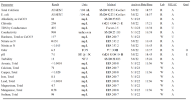

Hi,
I would appreciate help choosing between two whole house water filtration systems quoted for a new construction home on a mountainside in Vermont. Water is from a drilled well. I have attached the water test results. The results show high iron, manganese, turbidity, odor, TDS and hardness. Both vendors propose to add a reverse osmosis system at the kitchen faucet in addition to the whole house system

Vendor #3. For completeness, I will also add what the plumber had suggested. His test results were different than the other two: iron 6.0 PPM; 0 PPM manganese; 11 grains per gallon hardness 6.7 PH.
