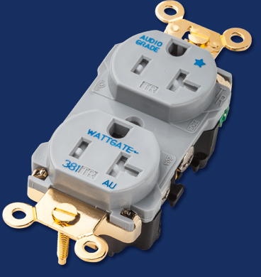

    You try this at home and report back what you find. Once you do you may be disappointed since they are the same on the inside.
    Don't fret though, there is a better grade available. This is the receptacle for you. They are the best money can buy. Nothing else on the market even comes close.
    If a little bit better is a little bit safer then a whole lot better is a whole lot safer, no?
    [​IMG]
    * Audio Grade
    * Ultra heavy-duty triple wipe contacts
    * Silver plated solid brass terminal clamps, mounting stap, rivets, and grounding strip
    * Glass filled high temperature nylon housing
    * Superior ground contact
    * Wattgate Three Layer Plating Process*
    * 20A/125VAC
    *WATTGATE Three Layer Plating Process
    1. Oxygen free copper plating
    improves conductivity
    2. Electroless nickel plating
    necessary to prevent the leeching of the copper through the pure gold layer
    3. 24k gold plating
    http://www.wattgate.com/products/381/
