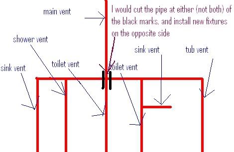

I have back to back bathrooms. After discovering water damage, and that the wall around the tub, and the wall that seperates the bathrooms was filled with dirt. Literally, two feet of dirt PACKED into the wall and around the tub, sopping wet, hence the water damage.
Both bathrooms are small, no cabinets, wall mount sink etc. The MB bath has the only shower, the hall the only bathtub. All of the plumbing is in the wall that seperates the two bathrooms.
Right now, my bathrooms are shells. What we are left with are just the drains and supplies, is shown in this paint drawing(supplies arent shown, they are above each drain):
http://img.photobucket.com/albums/v284/orionsmamma/untitled.jpg
I would like to try to make the two bathrooms into one. If I can plug the shower drain, one of the toilet drains, and then remove the venting and piping, I would have enough room on the right side to create a doorway between the two rooms.
This is a diagram of showing the drain/vent lines, shown as if you were standing in the door way to the hall bath looking a the back wall. there are also a few copper supply lines that are not shown and go into the cement. The vents go into the cement as well.
http://img.photobucket.com/albums/v284/orionsmamma/plubmingproposal.jpg
My other option is to cut up the concrete floor and move the drains. From my reading, the hardest part is getting a hole in the concrete in order to use a concrete saw. Well, the hole is already there, after removing the tub we discovered a square cut in the concrete exposing the tub drain piping.
If it were your space, what would you do? Would you cut out the concrete and redo all of the piping, or close up the extra drains and work with the existing piping? Should I just put the two rooms back togeter as seperate bathrooms? Keep in mind, all of the piping that I can see is very corroded where the dirt was packed around it.

As a practical matter, you only good option is to draw the new bathroom and then install the piping for it, after abandoning the existing stuff. Trying to make the existing fit a new design would be counterproductive. It would take more time, probably money, and give you a less than ideal drain systesm.

What I really want is a space large enough to have cabinets for storage, a double sink, and enough room to bathe my 2 young boys. Now there is no room for storage options. The hall bath has only a tub, The only shower is in my bedroom.
If I were to combine the two rooms, I would have to move the plumbing, or at least cap several drains and remove part of it. I know that it is a major undertaking, and could involve pulling up cement. My thoughts were that because there is already a hole in the cement, It may be easier. The plumbing is old, the bath drain was corroded to the point that the threading broke off, leaving a constant leak for who knows how long.
I was trying to figure out if I could just cut and cap some of the plumbing that wouldnt be used anymore, and create a walkway where it was removed. I dont know if that would be an acceptable, effective permanent solution or to code though.
I ran into another problem with that Idea though. On the left side, where the sink and shower were back together, are hot and cold water supplies about 6" apart. on the right side, there is only a cold water supply, the hot is piped over from the left side. That seems to present a major problem, in order to install a tub where the old one was, I would have to bring hot water all the way over. If I were to put a walk or door way in, the hot water supply would have to go around it somehow, it comes out of the cement in what would be the middle of the walkway.
So, Im right back to pulling up the cement, which I dont really have time for. I know well the saying "if you dont have time to do it right now, when will you find time to re do it?"
On one hand it seems smart to pull up all plumbing and redo, but I dont have the funds to hire a contractor, and we need a toilet and shower asap. If we do pull the cement, we will be doing it ourselves with a plumbing book. Ive almost decided to just put the two baths together again, with a shower/tub combo in the hall. What is still nagging me is this: the shower drain (under the cement) was broken at the threading and leaking/ the dirt under the cement is pretty moist. Should I tear up the floor with the intent to replace/check the other piping, or just fix what I can of the tub drain and put everything back together?
The big plan started at fixing the leak, turned to removing the dirt/mud, and is now basically to get my bathrooms in working, to code order so that we may use them again! I would like to have more space, but it is kinda nice to have my own bathroom. I want the plumbing done right (do it right the first time ya know?), but I would like to minimize costs.

What a sensible person would do, unless they are a maochist, would be do draw the new bathroom and then have professionals do the plumbing. A job of this scope is more than just putting a pipe to the spot you need it.
