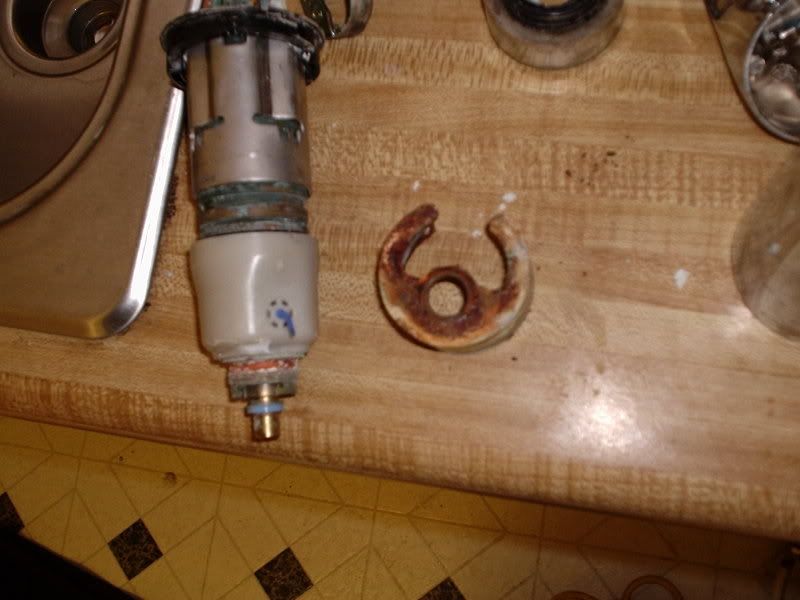

I'm heading out right now to replace, not repair an 875 series Moen KS faucet.
The backflow diverter is wore out leaking down through the cabinet into the basement below.
Was able to diagnose over the phone since she stated it never leaks when water is off.
Told her to pull the pullout spray to eliminate that connection in the body that mimics
the same sometimes.
Told her I can't get that diverter piece and she opted for entire replacement, a Delta.
She also stated the handle assembly was getting very difficult to turn over time.
That's a cartridge I don't have to worry about straining myself to get out as well.
Dunbar Plumbing
2,920
10
www.KoldBreeze.com
Damn, I'm good
Hit this one right on the nail, 14 miles away.
Has the trademark damage of the support bracket, I couldn't take this old Moen faucet back home to get that plastic sleeve off the body; from the way it looks, it doesn't come off.
If that is the case then you can't replace these newer 875 series faucets.
In the inside of the faucet body (chrome outside) you could see where this faucet was leaking for nearly over a year, not a couple/few days like the customer was thinking; it just got worse is all.
Da Cha-Ching!!!
