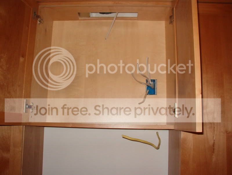

    Just when everything was going so well...
    Over the range I have installed a 21 cu. inch adjustable Carlon box. There are four pieces of 14/2 that get tied together and one 12/2 that is to be wired to the single receptacle for the range hood. That exceeds the capacity of the box if I figure correctly. A standard box extender might save me (I can adjust the box back into the wall quite a bit) but it doesn't fit over the adjusting screw for the box.
    Options?
    1-cut away the extension to fit over the adjusting screw in the box
    2-extend the box in some other way on the inside surface of the cabinet
    3-stuff it all in and hope nobody notices
    3-Go into the garage on the other side of the wall and rewire
    4-remove the cabinet and rewire-I didn't really say that.
    Any advice is most welcome, thanks.

    Make it up cleanly and no one will notice. If the wiring all enters from the top, just cut them so they will fold up once. If they are coming in top and bottom you need more wire but still can be done.
    And....do your make up on rough in next time!!

    Despite when make-up is done, it is still a violation.
    My only questions are:
    1. Why did you use 12 to feed the single receptacle instead of 14?
    2. Is there a device in this box, or is it all just make-up?

    MAN! You never cease to amaze me! You are actually condoning putting 27.25 cu/in of wire in a 21cu/in box????? Are you for real??
    OK, maybe this is not a "burn the house down" or "easily kill someone" violation, but IT IS STILL A SERIOUS VIOLATION! And on boards like this we DO NOT give advice to DIYers that promotes any install that is in violation of codes. That is a plain fact that you need to accept. If you don't you'd better get used to changing names a lot because you are bound to get yourself banned from quite a few sites.

    I understand it's a violation, I'm trying to gain some knowledge as to how to correct it. I appreciate your input.
    One 14 feeds the other three which are stubs to under counter lighting. The 12 is for the range hood receptacle in the same box. I'm planning on putting a single receptacle in, not a duplex. I'm not sure what everyone means by "make-up".
    BTW, this box was roughed by an electrician. He would have fixed it, but I needed to move ahead and he's not available for another week.

    Remove the 12/2 from the box and hard wire the hood. Violation gone.

    Way too easy, my head is swimming........ Let me just say, "duh!". Now if I can do it with minimal mess...

    Thanks Sparky, the box is indeed not made up yet. Remind me never to wire a log cabin. I'm going to have to bust into the wall from the other side to correct this. In a log house I'd be SOL. Luckily the other side is an unfinished garage and I won't have to spend any time making the patch look nice.

    It's done, thank you gentlemen.

    There ya go! Looks fine.
    You'll likely have to move the 12/2 over to the left just a bit when the hood gets mounted. No big deal since the hood will cover anything you do.

    Thanks again for the advice. The wire is exactly where the knockout on the hood is, so installation should be straight forward. The motor is a separate unit that goes inside the cabinet and fastened to the hood. It has a pre-installed power cord that plugs into one on the hood.
