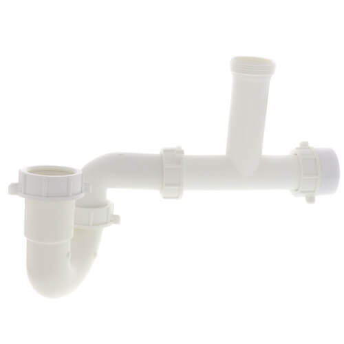

Consider Rectorseal Magic Trap. Even UPC approved, much to the horror of some (parenthetically).
https://rectorseal.com/product/magic-trap/ That would be allowed. That would make the vent under the lavatory, but it's pretty compact. Then the drain line could join the other drainage through any 1.5 inch, or greater, path that went down at 1/4 inch per foot or steeper.
You can also put an AAV into a wall in a box that has a louvered access panel. That is less good with an outside wall, because it would displace a bit of insulation.
You can do what you proposed in #9 with a 1.5 inch trap as long as the developed length from the U of the trap to the vent is 6 ft or less. Developed length would be what you would measure if you stuck a tape measure though the pipe. If 6 ft is not enough max distance, what do you need?
With a 1.5 inch trap, you can use a slip joint trap into a trap adapter. That adds flexibility.
