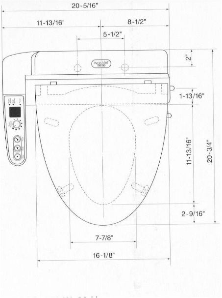

Chloe Bidet seat fitting chart
Keys, E=elongated, R=Round, Flush type,
G=gravity, PA=pressure assist
Manufacture | Name | Model | Year | Type | Flush | Chloe fit? |
TOTO | Dorian | CST914 | 1999 | One Piece | G | NO |
TOTO | Pacifica | CST904 | 1999 | One Piece | G | SW824 |
TOTO | Prominence | CST894 | 1999 | One Piece | G | NO |
TOTO | Carolina | CST884 | 1999 | One Piece | G | SW824 |
TOTO | Carlyle | CST874 | 1999 | One Piece | G | SW824 |
TOTO | Supreme E | CST864 | 1999 | One Piece | G | SW824 |
TOTO | Supreme R | CST863 | 1999 | One Piece | G | SW823 |
TOTO | Ultimate E | CST854 | 1999 | One Piece | G | SW824 |
TOTO | Ultimate R | CST853 | 1999 | One Piece | G | SW823 |
TOTO | Ultramax E | CST854S | 1999 | One Piece | G | SW824 |
TOTO | Ultramax R | CST853S | 1999 | One Piece | G | SW823 |
TOTO | Vespin | CST764S | 1999 | Two Piece | G | SW824 |
TOTO | Drake | CST744S | 1999 | Two Piece | G | SW824 |
TOTO | Drake ADA | CST744SL | 1999 | Two Piece | G | SW824 |
TOTO | Provincial E | CST724 | 1999 | Two Piece | G | SW824 |
TOTO | Provincial R | CST723 | 1999 | Two Piece | G | SW823 |
TOTO | Carusoe E | CST714 | 1999 | Two Piece | G | SW824 |
TOTO | Carusoe ADA | CST714L | 1999 | Two Piece | G | SW824 |
TOTO | Carusoe R | CST713 | 1999 | Two Piece | G | SW823 |
TOTO | Reliance E | CST704 | 1999 | Two Piece | G | SW824 |
TOTO | Reliance R | CST703 | 1999 | Two Piece | G | SW823 |
A/S | 2097.331 | 1997 | One Piece | G | NO | |
A/S | Hamilton | 2092.017 | 1996 | One Piece | G | NO |
A/S | New Lexington | 2037.100 | 1996 | One Piece | G | NO |
A/S | Cadet EL | 2898.012 | 1999 | Two Piece | G | SW824 |
A/S | Cadet RF | 1999 | Two Piece | G | SW823 | |
Kohler | San Martine | K-3435 | One Piece | G | NO | |
Kohler | Rosario | K-3434 | One Piece | G | NO | |
Kohler | Rialto | K-3386 | One Piece | G | NO | |
Kohler | Memoirs E | K-3429 | Two Piece | G | SW824 | |
Kohler | Wellworth E | K-3422 | Two Piece | G | SW824 | |
Kohler | Wellworth R | K-3423 | Two Piece | G | SW823 | |
Mansfield | Alto E | 135-160 | Two Piece | G | SW824 | |
Mansfield | Alto R | 130-160 | Two Piece | G | SW823 | |
Eljer | Cypress | 131-2120 | 1999 | Two Piece | G | NO |
Eljer | Aqua-Saver | 091-7025 | 1999 | Two Piece | PA | SW824 |
Eljer | Patriot R | 091-1120 | 1999 | Two Piece | G | SW823 |
Eljer | Patriot E | 091-1125 | 1999 | Two Piece | G | SW824 |
Gerber | 28-790 | Two Piece | G | NO | ||
Star | Orion | 1999 | Two Piece | G | NO |
Chloe round = SW823, Chloe Elongated = SW824
If you have newer information on which toilets the Chloe will fit,
Please send updates and fitting information to: toilets@psbl.com
