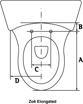

the Zoë Washlet is designed for elongated toilet bowls, and may be used on all toilets with the following dimensions.
larger picture

Elongated Bowl:
A: Approximately 18-1/2 inches (470 mm)
B: Minimum of 29/32 of an inch (23 mm)
C: Approximately 5-1/2 inches (140 mm)
D: Minimum of 8-7/8 inches (225 mm)

The washlet may not fit certain toilet bowl designs (check above dimensions).
Do not use the washlet on toilet bowls that do not conform to dimensions above.
On certain models of round toilet bowl designs, the inside rim of the toilet bowl may be visible after installation of the washlet. This will not affect the washlet's efficiency.
