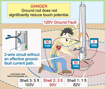

Here is a picture to help you grasp the idea of a grounding conductor.

Question, are you saying that the metal casing is not the same ground as the electric company's meter base, or the power company pole or tower ground or the ground rod ground many houses have or the metal water line ground the NEC requires or the ground used back at the electric generation plant?

Your right, it will conduct electricity, but at a high impedance, which will NEVER open the circuit breaker and clear the fault... this is the danger.
The whole time buddie! Look at it this way, ground rods and other grounding electrodes we install are only for lighting and surges from higher voltage lines, the actual ground wire on a light fixture or receptacle actually tie back to the system neutral, this is what allows the circuit breaker to open during a fault, now sure, we bond the ground rods and such to the system neutral, but it does nothing in terms of protecting us during a fault.
Here is another picture to study, this one actually involves a service without a neutral, but it may help you understand that the earth does nothing in relation to circuit breakers. Picture the motor shown, a well casing with a well pump that has a ground fault.

Grounding and Bonding are very hard for people to understand, even electricians.... alot of it has to do with the wording in the Nec. but either way, education is the only answer. And I apologize to the OP for disrupting his thread.

Okay, let me show you a picture of a control box I came across working in the field....
They didnt have enough conductors for the pump, so they used the ground wire that normally protects people from electric shocks as the extra wire they needed.
If a ground fault were to ever occur in the well pump, the breaker would never open, and anyone walking in the yard could be seriously hurt or killed.
