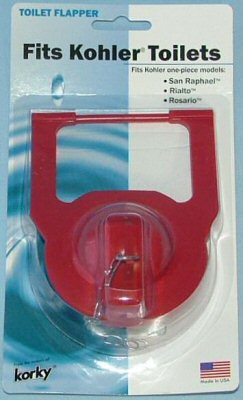

Reviving this old thread because I have a client with same problem. Flapper leaks, new flapper leaks just the same.
This is the system with the rectangular standpipe. The flapper has a rectangular rubber "ring" that fits around the standpipe.
The problem is the chain pulls on the flapper sideways and the flapper comes back down not so straight. Works about 80% of the time, the other times you have to jiggle the lever.
I talked to Kohler tech and they appear to be aware of a design issue. They offered to send me a free "longer" actuating lever. Just got it in the mail. It's no different than the one already in the toilet.
Has anyone found a fix for this? Does anyone make a kit for replacing the entire guts of the toilet with something that works?

Eric,
You are talking about a different system. The one I am talking about has no hooks, holes or any other mounting provisions.
See picture. The back part of the rectangle (thinner) snaps into a groove on the back of the rectangular tube.

Verdeboy
2,041
My mistake. Maybe you can replace the flush valve with a more universal one (that has the little hooks) and get a standard Korky flapper.
But before I tried that, I'd try adjusting the chain on the flapper you already have. You might need to leave a little more slack. Also, If the lever has a metal rod that is attached to the flapper, maybe you can bend it a bit to lift up the flapper straighter, or you can replace that lever with one that you can bend in such a way.

Thanks Eric!
I already fiddled with the chain and all that. There is no room in the tank to even make a custom lever that could pull straight up on the flapper.
Took your suggestion and looked closely at the Kohler site. Lo and behold, their current parts diagram for the Rialto K3386 shows a standard flapper style with eyes and corresponding hooks on the rectangular tube.
Somewhere along the line they must have changed it when they realized the old style isn't working! All I have to do is update to the current Rialto flush valve.

Thank you for the great info in this forum. I figured it was a design issue with the hinged flapper and spent the earlier part of today looking for an appropriate replacement with some re-enforcement on the sides to prevent it from traveling. I was just about to send Kohler threats for new guts when I discovered (upon finding my model number, mine is K-3384-2 which is located imprinted in the back of the tank) that they have phased out the korky style cheap rubber flapper with a better one. 84995
Replaced by GP84995 http://www.kohlerserviceparts.kohle...ervicePartID=7742957e75934809abf3b23a91dc463a
This new one seems to have a solid plastic stick that snaps into the Hinge slot, and sides with more rubber and grooves to keep the flapper in place. I am going to order one and see if it resolves the problem. Will try to post again if successful.

YES! This is the part I have, but for the life of me I cannot figure out how to install it, and this appears to be just about the only Forum thread on the entire Web dealing with this. How do you attach that black plastic bar to the grooves on the back of the rectangular flush valve? The instructions say "with the prongs on the bar pointed toward the back of the flush valve, slide the pivot rod onto the valve." What does that mean? How do you slide the rod onto the valve? Is it supposed to snap into the groove? I tried that but wasn't sure just how much force to apply without knowing I was doing the correct thing, not wanting to end up breaking that plastic rod...Anyone know if snapping it in is the correct way to install it? Thanks.
BocaDr1
Boca Raton, FL
I finally called Kohler...
OK, so I called Kohler and they said definitely do not try to snap the bar into the groove! After they explained it to me, it seems the instructions printed on the packaging for the part are backwards - that's the problem...the prongs on that black plastic bar have to be pointing toward the back of the toilet and NOT the back of the flush valve, as they say in the instructions! If the prongs are pointing toward the back of the flush valve, they're actually pointing toward the front of the toilet. The black plastic bar has to be slid into the correct groove on the back of the rectangular flush valve starting at 1 end of the bar. So if the prongs are pointing toward the back of the flush valve, they're blocking the path of sliding the bar into the correct groove...they have to be pointing the opposite direction, toward the back of the tank. Then the bar just slides into the groove, you slide it back and forth a bit in the groove so you can then rotate the bar to reposition the prongs so they now point up. Then just attach the red rubber arms of the flapper to the prongs.
It seemed to me a good way of estimating which was the correct groove to use for the plastic bar so that the flapper will seat correctly was to remove both red rubber flapper arms from the plastic bar and manually seat the flapper correctly over the drain opening in the tank then note with your finger which groove they appear to line up best with - maybe count the grooves from the bottom - and then position the plastic bar in that groove and reattach the flapper arms. In my instance, this new flapper in the correct position completely fixed the cycling problem with the Rialto.
