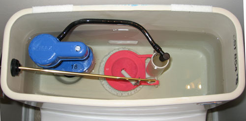

Hi there. I have a Toto Ultramax with a GMax Type A fill valve that seems to need repair or replacement (toilet keeps running, valve continues sending water into the tank even after the tank is full, causing water to constantly run down the overflow tube).
Is there a Korky product that I can use for this? All of the references I have seen to Korky fill valves appear to be the "type B" style. If my toilet originally had a "Type A" fill valve, can I replace it with a type B? The photo attached is the kind that is in my toilet right now.
I'm trying to find a way to use something I can buy at Home Depot, rather than special-ordering one from the manufacturer.

Your GMax toilet will take a "Type B" valve. They are interchangeable. It will take the Korky 528T "Fits Toto" fill valve no problem (I threw away that Chinese Vareto Type A fill valve in my Gmax Drake and replaced it with the Type B Korky 528T, which is much quieter on shutoff.) (FWIW, the regular, white-cap, Korky 528 will not work right in your toilet, because it refills at a standard 20% rate, whereas Toto GMax requires 40%, which is why Korky makes the 528T [fixed 40% refill rate, blue cap] and the 528MP [variable 0-40% refill rate, silver cap].
However, the Terry-recommended 528MP that you can get at Lowe's (Lowe's calls it the 528MPK) is now selling for less money than the 528T (for no good reason), so you should follow Terry's advice and just get that.
To expand upon what Terry said, Toto now uses a version of the 528MP MaxPerformance fill valve as the Toto Universal Official Replacement valve on EVERY Toto toilet. One valve for the whole product line. That means that if you called Toto for the replacement for your Type A valve, they would send you something that is basically the same as the Korky MaxPerformance fill valve that you can get at Lowe's for less than half of what Toto would charge you for essentially the same thing.
That's why Terry's expertise is so valuable.
Depending on how old the toilet is, Toto might send you a new one for free.

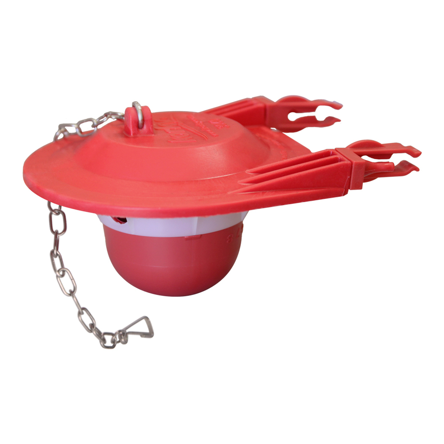

Well - I guessed my repair worked for a day and since this morning it started running again. Its a single piece CST624 unit (Lagato?) I cleaned the flapper but the water level dropped in about an hour after I turned off the main. Not sure whats wrong. I will clean and reinstall the filter but something else is wrong.
If you turn off the water, and the water in the tank lowers, it's the flapper, or at least the flush valve maybe sealing to the tank.
Most of the time, the flapper.

The Legato uses the Toto THU331S flapper, among others. Its exact analogue in the real world is the Korky 2021BP flapper. Korky makes both flappers, and they are the same thing. Literally, it goes in one box that says "Toto" for sale in some places, and another box that says "Korky Fits Toto" for sale in others. Accordingly, you can just look it up online or at your local HD (where, for no reason, they call it a 2021CM):
http://www.homedepot.com/p/Korky-3-in-Toilet-Tank-Flapper-for-Toto-G-Max-2021CM/202666003
This one will go right in without any adjustment and probably solve the problem immediately.
Also, Korky now makes a Universal Toto flapper, that will work on any Toto with a 3" flapper.
That one requires you to set a little white band around its ouside to a certain position, depending upon your toilet, but it works properly and is kind of cool.
Also available at HD: http://www.homedepot.com/p/Korky-3-in-Toilet-Tank-Flapper-for-TOTO-2023CM/205213624
