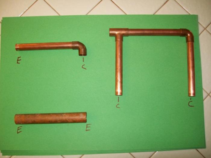

I would like to make an attempt at sharing some information about pipe insulation. Hopefully I will be able to post some pics of how to make fitting covers and install insulation properly. I have 30+ years of plumbing, drain cleaning and pipe insulation experience at two University/research settings.

For the typical homeowner I suggest using the Armaflex ARMACELL foam pipe insulation with a minimum 1/2" wall thickness. I see Home Depot sells it in a 3/8" thick wall that is pre split with the tape. I would steer clear of this and seek out a plumbing supply house that sells the solid tubes. You will need to buy the Armaflex 520 adhesive too. You will learn to cut angles with a knife so it is better to handle when the wall thickness is 1/2" and not already split open.
You only need some simple tools and the adhesive to do a nice job with little practice that I will share.
1. Knife= I use a hacksaw blade that I sharpen down on the back edge to a point. It will need to be pointed. I would not use a utility knife, you need something with some length to it. Also this material will dull a knife blade quickly. A hacksaw blade does a great job when roughed up with a good file. Saw blades are cheap too. You could use a steak knife but you will need to keep it roughed up. You could use the teeth of the saw blade but the edge will be rough, you still need a point to stick in the insulation to cut circles.

If you are building or remodeling a home you will need to make the holes for your pipes at least 1" inch bigger than the pipe and 2" would be better. Make certain that you have plenty of room between the pipes to make the insulation fit around the pipe without it getting squeezed or pinched. Be sure to take in account for extra room of valves and unions too. Squeezing, pinching and tie wraps are big NO NO's If the outer skin is damaged, coat it with the glue or paint it with glossy water borne paint to identify if it is a hot or cold pipe.
If you are going through a floor, you may want to take a piece of rolled metal or bigger pipe and put in the hole to sleeve it first. Then install your pipe, then the insulation. As you install the piping system you can cut pieces a couple inches shorter and slide over the pipe as you go. Take great care not to damage the inner or outer skin. keep the unused sections in a safe place to avoid damage. If a piece of pipe or metal gets laid across it, it will get permanently squished down. Cut out and discard areas that get squished or poked. I am in no way affiliated with the Armacell company. I am doing this on my own for your information.
