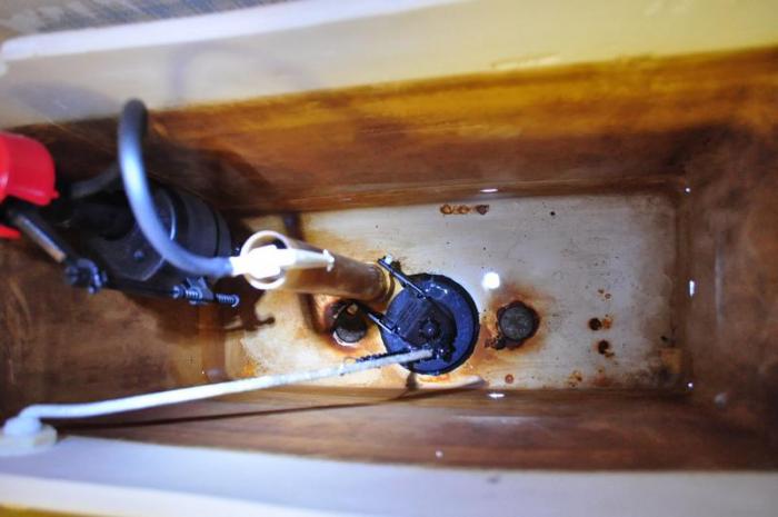

Same problem...slow 'leak.' No sound. Tank level drops. Tops off about every 1-1/2 hours. Fill tube is not below water level. New flapper did not solve. Lip of drain feels perfectly smooth. With water shut off, the tank over time empties completely.
What are possible failure modes causing this?
Is there a brand of flapper known to be "the best" for making good seals?
Could there be a pinhole leak in the tube at the very bottom, allowing tank water to enter the bowl. If so, what is fix?

Inside pic of tank attached as requested.
Redwood
7,335
13
I'd start by tossing that POS Fluidmaster Flapper in the trash and using a Korky Flapper...

The other possibility is that the overflow riser is cracked where it is glued at its base. That or the flapper are the only ways for the water to leak out. It is NOT the gasket under the flush valve, or it would be leaking onto the floor, not into the toilet.

You can check the overflow riser for cracks by applying a slight pressure at the top in different directions and see if the leakage rate changes.

It's hard to know from your description. Forgive if I'm being redundant, but I would flush it, let it fill, turn off the water at the wall valve. Let it sit. See how low it goes. You say it drains halfway. If it drains halfway every single time to the same spot, I would check that overflow riser for a crack. Pinch it a little at the top and make sure it doesn't deform.
In your photo, you appear to have a fluidmaster flapper in there. You say you also tried a Korky, and still the same problem? If it's not a crack in your overflow riser, you might the Korky Easyfix 2003BP kit Link to kit which allows you to put a new seat on the flush valve. The other possibility would be to change out the flush valve. That isnt too complicated a job. The hardest part is removing the tank and the old flush valve, which often find ways to make that challenging. Here's a nice Korky kit with a flush valve I have installed on several toilets; the overflow riser is oversized and easy to adjust without cutting it: https://www.korky.com/products/flus...adjustable-2-flush-valve-tank-bowl-gasket-kit
