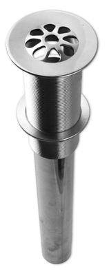

vessel drain without overflow
The drain by Mountain Plumbing Products works better with vessel bowls without the overflow.
http://mountainplumbing.com/mt749
Or the Kohler K-7124
