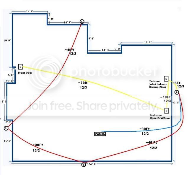

I have a house-relatively large ~5000sq ft and want to control the outside floodlights from the front door- and both master bedrooms (one down and one up). I'm looking at the standard double 100w type floodlights. Electrical panel is on the first floor- and lights will be on the sofits.
Is there a better way to wire- other than bring the power in at the second floor switch and save ~6ft of 12/3. It seems like a LOT of wire. Is it too long-is 10/3 and 10/2 required for such a run? Too much voltage drop. Or no big deal since it's just lights? Just the lights will be running on this circuit.
Thanks in advance-
