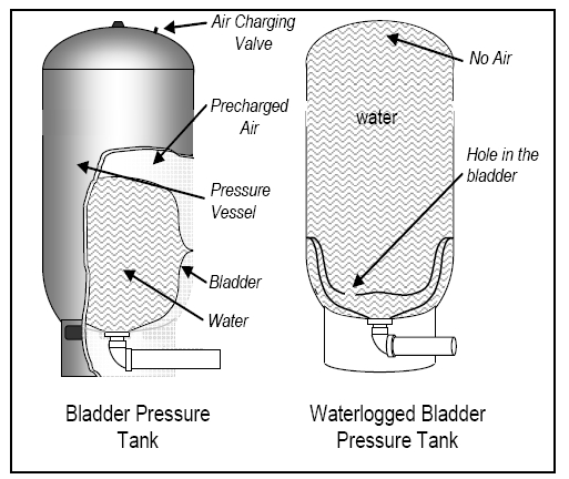

Installing something that automatically shuts off the water to the house isn't very commonly done in the US. Most leaks start as minor flows not catastrophic deluge, and in homes that are occupied they're typically discovered and dealt with before major flood damage is a possibility.
The most common big leaks happen when say, a long ignored dripping leak from a old washing machine gives up the day after you've left for a 2 week vacation. The cheaper solution is to manually turn off the water when you plan on being away for an extended period. Catastrophic deluge from hot water heaters are possible, but rare. In many states the building code requires that the outflow of the T & P valve be plumbed to direct the water drain to prevent both the flood and scalding.
When a PRV valve fails it doesn't usually fail catastrophically- it usually just seeps, and if the lowest pressure leak point is the T & P valve (often is), having the outflow of the valve plumbed to dump into a drain (as required by code in many locations) isn't an outrageous expense. If the seepage rate is low you might not even notice it (safe for the house, but could add up on the water heating bill.)
A basement sump and float activated sump pump is a common feature in many houses, and that too would usually be able to keep up with a fairly major leak.
I would take "ET" to mean Expansion Tank, no?
The expansion tank needs to be pre-charged to your intended system pressure for it to work optimally. Most expansion tanks sold into the hydronic heating market come pre-charged to a much lower pressure than 60psi. If you water pressure measures 60psi (go ahead and measure it), shut off the main water to the house and open a tap (cold or hot) until the pressure is low. Pump up the tank with air until it's 60psi (they usually have the same type of valve as a car tire), then turn on the water to the house. On potable water systems the expansion tank should last for decades, but periodic checking of the pre-charge (say, every couple of years) is prudent. With the water to the house turned on you can't test it, you must bleed down the system pressure first, as described. If gets to the point where it's losing pressure, the valve can be replaced. If the internal bladder fails and leaks you may only discover it when the T & P valve opens up. When you tap the side of the tank on the air-valve end it should ring, and on the plumbing end it will be more of a thud. If it thuds on the air valve end it's either completely lost it's pre-charge, or the bladder is shot.

You asked about how difficult expansion tanks are to install. Really quite simple. They are installed in the incoming water line. The line is cut and a small section taken out and a tee is used to reconnect the pipe ends*. The expansion tank come with an adapter to connect the tank to the tee. That's it for the basic install, but the tank must be supported. There are several ways to do this depending on the location of the tank. The only plumbing skill is knowing how to sweat (solder) copper fittings. It's a pretty easy DIY job. You do have to match the tank's air pressure to the incoming water pressure. Pressure gauges are inexpensive and are available at any hardware store, they are handy to have anyway. Air is applied to the tank just like airing a tire, and the pressure is check with a tire pressure gauge.
*If when the pipe is cut you can move one or both pieces enough to get the tee inserted, no need to cut the small piece out.
In lieu of buying a water pressure gauge, when the ET is installed with somewhere below the supply pressure (they often come precharged to 40psi which should work), just use a car tire pressure gauge on the fill valve - the air pressure will become the same as the water pressure which is why you must have the water turned off and the pressure relieved in the water supply system to check and verify the ET's air pressure. Once you know the water pressure, turn the water back off, open a faucet to relieve all pressure then pump the tank up to that value. Close the faucet and reopen the water shutoff, and you're done. It's handy to have a water pressure gauge, but not required in this case. By setting the precharge to the same as the water pressure, the air bladder is at its neutral position and will last the longest since it won't have to move as far during cycles or be under as much stress.
The plumber simply made a common mistake and needs to come back out and install one with the pressure set equal or slightly higher than the incomming pressure... I dont know who is gonna foot the bill for this but it cannot be that much money involved ..... just pay the guy to come back out and move on....
I would also suggest that you pipe the t+p drain to the nearest floor drain or sump pit
as an extra precaution
