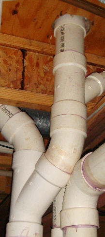

One more question
Does a closet bend have to come immediately after a toilet flange, or could you install a length of straight pipe to bring the closet flange below the joists?
33,603
1,042
You can either use a "spigot" bend which connects directly to the flange, or a "hub" bend which has a section of pipe between it and the flange. As for the "P" trap, the elbow that comes with it is a "square turn" street elbow.
JoshRountree
53
West Jefferon, NC
Let's say the joists are 12", could I use a coupler to attach a piece of pipe to the toilet flange to get me below the joists, then use a closet bend from there?
