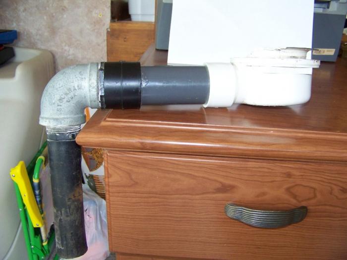

    I am trying to locate a shower drain fitting but having no luck. Been to all the local stores and have done an exhaustive search online with no results. It is the weekend so I can't call a plumbing supply house for help, thought I would try here.
    I have a shower setup that isn't the normal way so I have to improvise. For whatever reason when they built this house 40 years ago they put the shower drain about 2 1/2 feet from the commode. I removed a cheap square 32" shower stall that sat on a raised tray and the drain was plumbed over to the cast iron pipe in the concrete. This is in a basement. I am putting in a corner shower stall but the drain isn't anywhere near the shower base drain opening. I am using a masonry blade in my circular saw and air chisel with my compressor to make a trench in the concrete to lower the plumbing down enough to fit under the new shower base.
    I am trying to replace this fitting because I tore it up removing the old shower stall. The fitting has a 2" threaded opening that attached to the shower drain and a horizontally located 1 1/2" non threaded opening for pvc pipe. On the bottom of the fitting it says, "PVC-DWV NO.82.305 WHITE US Patent NO. 3895398. I searched on google with these numbers with no luck as well.
    If anyone has any idea what this thing is called or where I could get one please let me know. Pictures provided below...

    Where are you located? The reason I ask is because that would never meet code and the PVC looks like irrigation pipe. There needs to be a 2" PVC line sloped 1/4" per foot to the main line with a 2" p-trap and riser directly underneath the drain of the shower. Since you're already planning on trenching the concrete slab, there is no need to find that fitting again and you can bring this new shower's drain line up to code now.

    They used a tub shoe:
    [​IMG]
    It is typically used as part of the waste and overflow for a bath tub:

    It doesn't look that much like whats in your pictures. Are you sure.

    I live in PA so being up to code isn't a big deal here. No required plumbing lic. or electricians lic either, for that matter, the only problem I would run into would be a home inspector getting inquisitive sometime in the future, I am not that concerned really.
    I was hoping to go with a similiar setup like I took out so I am not chiseling and cutting all kinds of concrete out of the floor. With my luck around here I would go all the way through the concrete floor and hit the water tables, flooding the basement. I want to make this as painless as possible. Thats why I am looking for this same type fitting.

    The tub shoe would be 1 1/2" and you said 2" so it is one weird fitting.

    Your setup appears to not have any trap, which is not only against code, is a very bad idea for both health and your nose. Neither does it have a vent. The fact that it drained is not the issue. Since it goes a ways, then drops down, it appears you have enough depth to do this right.

    The P trap is farther away, downstream, and yes this is legal and it has been discussed in recent threads here. We cold ask the original poster whether there was much or any gunk in the pipe.
    The fitting in question performs that same function as a "tight elbow" under an ADA lav. or as already mentioned, a tub shoe. Search on tight elbow. Geniescience

    Bust the concrete, and put in a new p-trap, this time in the right location.

    I just did a shower drain repipe for someone that "Didn't care about the code" when they added a shower. cause when they went to sell the house the inspector caught it was not up to code and not properly vented. It cost the person just a little over $1400 for just the plumbing repairs, that is not including replacing the tile, drywall and other things that had to get torn out to make things right.
    While you have it apart, DO IT RIGHT THE FIRST TIME!! Somewhere on this forum I quoted an old 1917 code book that hit the nail on the head about taking short cuts and such is not a way to save money even if it seems like you are. Cause in the long run you WILL have problems.

    But the problem is its just dumping into a floor drain = not right or code.

    naw, I located a plumbing supply house that has the same fitting and I'm going to do it my way. build a base and have it slope over and run into the same pipe thats there now.
