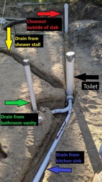

Long story short, I purchased a piece of property with a simple one level cabin foundation. One bathroom with shower/toilet/vanity and a kitchen sink. The guy was doing it all himself and passed away mid project. His son has been helping me with questions and has supplied photos of the build to help understand what was going on. But what I noticed about the plumbing is that it appears there are no vents. I've built a few homes and have always hired out the plumbing, but paid close enough attention to hopefully remedy this issue with some advice. There are no building codes enforced where this property is located and no inspections are required except for electrical. The concrete slab is poured and completely encapsulating the plumbing of course. The sewer main is protruding out of the slab. The main line is 4" and all the rest are 2". The kitchen sink drain does protrude out of the slab, it's just out of view on the pictures.
Besides your own take on the setup, I'm wondering if I can utilize the sink drain with a "Y" and continue it up into the roof once the building is built, would that be what's referred to a "wet vent"? How about the use of an air admittance valve?
Thanks for you advice, and I appreciate the forum! Here are a few pictures that were given to me.

Sink vents require no vent pipes under the slab. And a WC and shower can be wet vented via the lav drain, in which case they require no vent pipes under the slab.
But for that to work, the order of connection at that nexus where it looks like all 4 drains come together is important. Going upstream from the sewer, first (i.e. last when going downstream) should be the kitchen sink. Then should come the WC drain. Last (i.e. most upstream) should be the joint between the shower and the lav.

What you describe would work, but it would not meet UPC 2018 code, because it has an AAV. Now there may be a local code modification that permits AAVs or you might be able to get a variance by asking the inspector in advance.
I presume the cabin is in MN.
So if this is new construction, why can't you connect the kitchen sink santee to the roof vent piping?

That fitting he used for the toilet drain is wrong in so many ways. I think your going to have problems with clogging and poop smell in that cabin.
Just run the vanity vent through the roof.

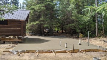

Correct its in Minnesota.
I didn't want to confuse the initial conversation to much, but there is a 12ftX16ft cedar log cabin already onsite, it will be used as the kitchen area. So with the log building, I can't run the vent in the wall with the exposed log interior. Hence the need for the AAV under the sink. the new construction will butt up to the existing building and all be sitting on the same slab.
This is something I was worried about, can you elaborate please? I did ask and he said there is a sanitary tee coming from the toilet into the main line, at that main junction.
Yeah. That's not what a sanitary tee is for. I think he very improperly used a side inlet sanitary tee on its back.
You need a vent to atmosphere aavs are barely legal even with a dedicated vent. Without one they definitely aren't. This will result in poor performance. Along with thre bad piping practices your bound to have some uses.
If your not that concerned with these issues ther very bare minimum would be to use the dedicated cleanout pipe as a vent and use the aav.
As a matter of integrity when/if you go to sell this cabin all of those pictures you shared, should be shared with the buyers. Then they should consult with someone they trust to be sure what they are getting into. Part of the purpose of code and its enforcement, would be to take personal integrity out of the picture, and provide a third party inspection, to ensure minimum standards are applied and people aren't buying things like this.

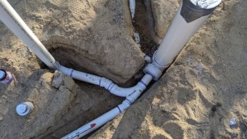

Thank you. I could not figure out what the picture was showing at the 4 drain nexus.
Since all 4 drains are coming together in that smallish area, I think that the connectivity could be fixed by breaking up a 4' x 4' or so (just guessing) area of the slab, and redoing the way the 4 drains come together. Basically you'd need to expose the end of the straight portion of the shower trap arm, the end of the straight portion of the lav drain, the end of the straight portion of the kitchen drain, the entire san-tee with side inlet on its back, and a bit downstream of there and a bit wider. That would let you (going downstream) join lav to shower first, then join in the WC properly, and then bring the kitchen sink in around all of that and connect it in downstream of the bathroom group.

I've been talking to the son, and texting him pictures. I showed him a wye and a sanitary tee, and he said it wasn't the wye they used. So that settles that. I explained the idea of busting up a section, and he said the center of the slab is 5" thick hardened concrete, not the normal 4k psi, plus rebar. Then he sent a bunch more photos, and in one of them I can see luckily the junction doesn't enter the deep footing, but comes close.
Am I understanding right, that with that sanitary tee the flow of water and mass isn't angled enough causing a stalling of momentum as it enters the main line?
I know this whole thing was a DIY, just afraid this is what issues I'd run into...
