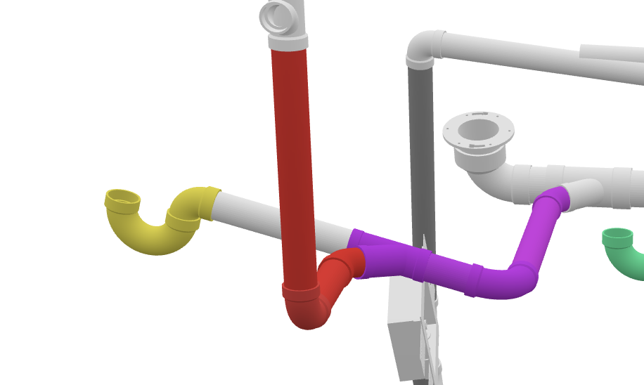

Wetvent in Bathroom Group with downstream laundry. Experts is this ok?
The dry vent line at upper right needs to stay within 45 degrees of plumb. To do that, run the trap arm over to the vent at the wall, vent it, and then route it horizontally toward where it needs to go.

here is what you mean right?

Not really. Looks to me as if you have a horizontal part. Can you come over to a 45 from the trap to a combo at the wall, and a 45 out of the combo? I am talking about the trap at the upper right, and it looks like you are bringing in the vent horizontally. You want that vent to be vertical, which is within 45 degrees of plumb (like a plumb bob hangs plumb).

Trap in upper right (now in yellow) is a wet vented shower drain...
This project has had a bit of scope creep. What started off as a simple bathroom refresh is now two bathrooms, two laundry, and a floor drain across two floors. Apologies for the confusion...
EDIT: ohhh you are saying to vent it on the other side of the room... along with the lav/wet-vent very interesting... I didnt think of that. I need to ponder that for a bit.
I think you may be saying that vertical vemt has the lavatory on it, and the lavatory then wet-vents the shower and toilet. That is good.
I had been thinking that thing on the vertical was a cleanout, rather than a lav. For your other fixtures, you drew the traps.

Could I impose with one more question. How do I measure the wetvent?
Is the Wetvent for the toile the puple pipe? or is it the Purple + Red pipe?
I thought that there was a maximum length of a wet-vent. (6ft in ma) unless I was mistaken. Thanks for the clarification :)
No limit on wet vent length. The venting limit is on a trap arm, the vent has to connect within one trap diameter of fall from the trap outlet.
