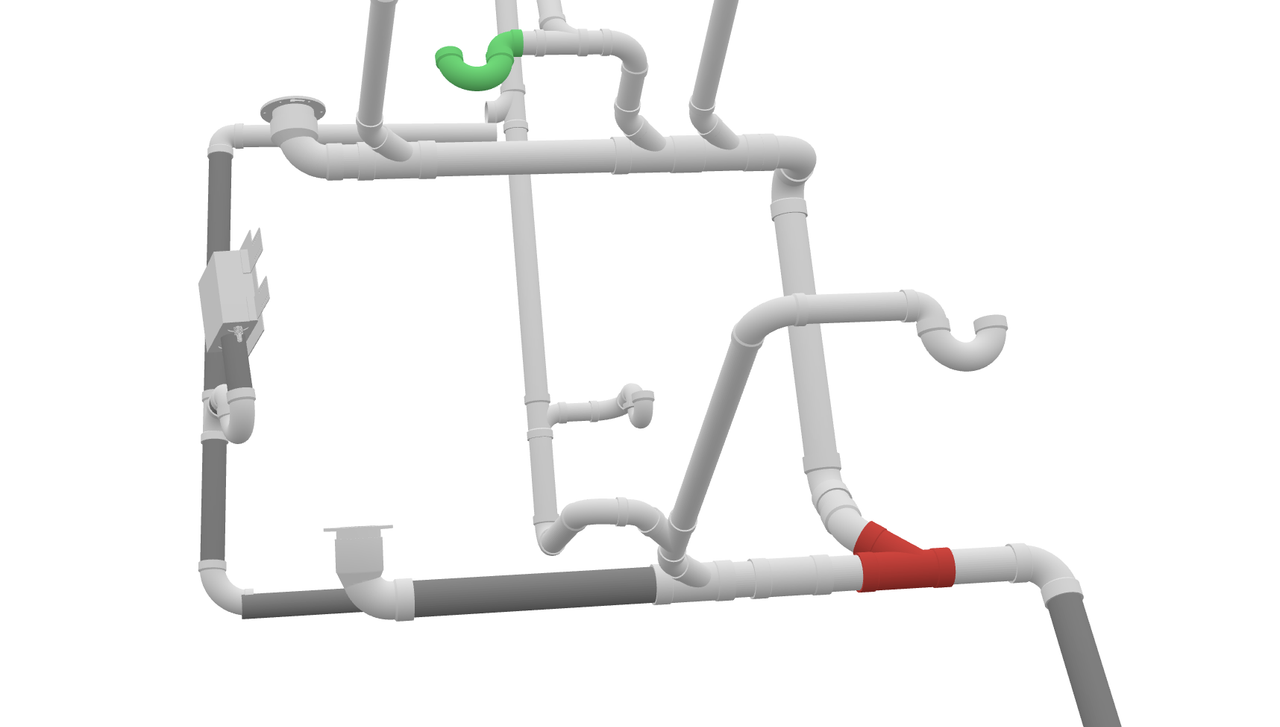

So, this is an image of the entire system I am building.
The green trap is an 'emergency' floor drain which will be on the floor under the laundry. (ill probably fill the trap with a bit of oil, so it does not evaporate.
Is the green trap ok to be used as a floor drain like this?
The dry vent line at upper right needs to stay within 45 degrees of plumb. To do that, run the trap arm over to the vent at the wall, vent it, and then route it horizontally toward where it needs to go.
The only constraint on the red wye is that the two inlets should have at least 1/4" per foot fall. Other than that it can be "flat" or upright or whatever.
Cheers, Wayne
Isn't that red wye a stack carrying suds? Does Massachusetts not have a "10 pipe diameter" or equivalent rule at its base for suds?
