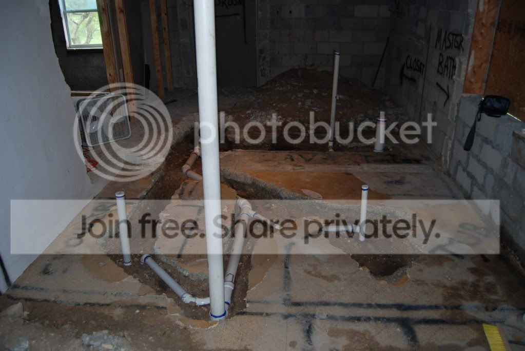

    Hello all,

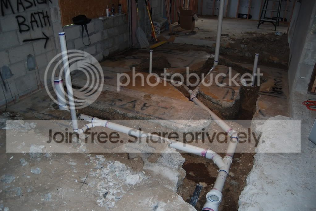

    As you can can see this is my first post on this forum. I have lurked like others do for a while. I was really hoping to just read others problems and not have to post about my own. But, alas, I have a doozy (I think) I have found out from a plumbing expert that there are issues with the way my DWV lines were setup in our new master bath remodel. I hired a professional to ensure it would be done correctly. Enough talking though, let me post a few pics so you can see what I'm dealing with.
    [​IMG]
    [​IMG]
    I was hoping to get some second opinions if possible. Any advice on how to pursue this situation would be great. PS the inspector signed off on this, and it has since been covered with concrete and framed walls. Luckily we haven't finished the bathroom yet.
    Thanks in advance

    Whats wrong with it?? Looks alright to me.
    Is there a lav on each of those stacks??

    I agree with C NUMB, it generally looks fine to me...unless you don't plan on continuing up the vent stack up for that lav sink, and I hope you don't plan on discharging anything into that 3" line from above other than a sink.

    It's plumbed to code.

    In KY that would all get torn out.
    No flat venting
    Every fixture must have a vent, and those don't.

    The only thing that I see in the 1st pic, is that your floor drains are not vented properly. The same issue that dunbar plumbing is suggesting
    Otherwise it would be fine

    The 2" stack has a lav. The 3" has a washing machine discharge(other side of that wet wall, you can see the outlines on the bottom right for W and D)
    Thats part of the problem. I was actually informed that 1. On the bathroom group, only bathroom fixtures can be used (Which now makes sense to me) Washing machine cannot be put into that 3" stack. 2. The shower drain (First picture, left foreground) does not connect above the 3" elbow to wash it out. These are things I am now learning about. I will have to contact the plumber in the morning and have a little discussion. Both of these issues are code violations that the inspector also missed. I was referred to the code 909.1 and also Florida Residential Code P3108 which both basically say the same thing. Either way, I might be out of luck. I will try to get it rectified. Thanks for your input. Time and time again, I have found this forum to answer all my questions and then some. I really do appreciate your efforts and I have a new found respect for you guys:)

    In Florida, the only problem you have is the washing machine as part of your wet vent. I still haven't heard the reasoning behind that part of the code to where it would make sense, it'll work fine and in fact a couple of codes back you would be OK.
    If your inspector signed off and the concrete is in I wouldn't sweat about anything you have there.

    It's an easy fix and a little more concrete cutting. I would not have the wm dumping past the shower and tub. Just to the north of you it would not pass.
    All they need to do is cut in a 3" wye before the 45 turn to the combo for the tub. Install a new 3" line towards the block exterior wall and run around the tub waste, cut the concrete towards the wm and install the new 3" line between the washer and dryer. Then remove the 3x2 combo to the shower and the 3" 90, bring the 3" line towards the wall, install 2 3"45's and a 3x2 combo center of wall(2" vent in the wall) with a 3x2 bushing in the head of the combo and a 2" 45 back towards the shower.
    Dunbar, here in Florida a bath group like that can be picked up on one wet vent.

    The washer draining past the shower and tub drains can be a problem, but your salvation may be that since it is a 3" pipe the water velocity may not create problems. You either had a lenient inspector or a pemissive code.

    Yes, the 3" does help, but still a no go. Unfortunately the inspector missed it, he didn't check for slope or anything. He just came and shook the stack with water in it and kinda glanced around. I just hope that they are willing to fix it.

    It's doubtful that you would have the traps siphoned on a 3" line. If you really want to have the work redone by the plumber, technically his wetvent does not meet current code, the installation did meet code from a from about 8 years back.

    It's suprising to me that Bonita passed it, they are a PIA on my end for commercial work anyway. The wrong part as stated above is you have bathroom and non-bathroom fixtures as part of a wet vent.

    if you had only a 2 inch drain in that floor, then yes ,
    their could be the possiblilty of the laundry totally
    filling up the drain line and siphoning the traps......
    you have a 3 inch drain, the hose comming off the laundry is actually
    only 1 1/4 inch dumping into a two inch trap then dumping into a 3 inch drain...
    a 1 1/4 drain cannot flood out a horizontal 3 inch drain.
    it is impossible for this to happen.......
    it CANNOT HAPPEN
    if you are still really worried about this,,,
    why dont you compromise with the plumber and simply ask him to install
    some deeper traps in the tub and shower boxes...just
    re- make them out of 2 inch elbows and nipples to make. deeper traps???
