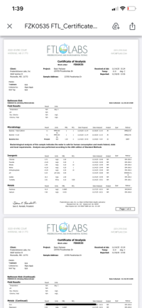

The test results from the lab indicated that the [COLOR=revert-layer] water[/COLOR] was in acceptable levels and that I had high iron.
What does 'acceptable levels' and 'high iron' actually mean?
Suggest posting the lab test report to define the actual numbers. The raw well water acid level will also have an influence on treatment methods including how much bleach and the amount of pH adjustment will be needed for the bleach to work effectively. As such, the lab report should also specify the pH level.
Does the water contain any arsenic? Arsenic is often present in well water, so arsenc removal is most commonly performed along with the removal of iron through the utilization of iron filtration media such as Kattalox Light, installed within a backwashing filtration system, similar in size and apearance as a water softener.

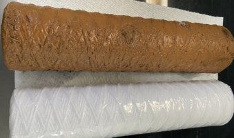

Also, the water runs clear and does not smell. The filter in the was after the bleaching the well. A new filter will get dirty (like the one inside canister) in about 1 week
If you get the filter dirty in a week, you need a bigger filter.
Is what the filter picks up mostly rust colored?

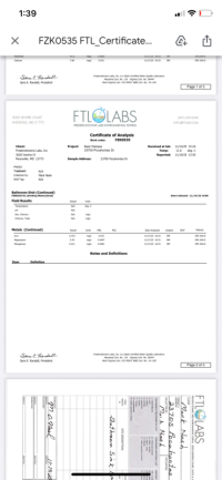

Thanks for posting the lab report. Are you able to increase the image resolution and then repost? Even with attempting to view a saved copy, the resolution was too low, resulting in the text becoming pixalated and unreadable when zoomed in to increase the size of the text. If the higher resolution file size becomes too excessive to include within a post, suggest saving the image to an online image portal, then post the link to the image within your post.

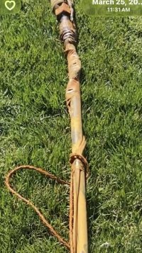

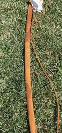

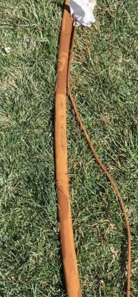

Yes sir have seen this video. Yes it is rust colored. I posted a couple of pictures of the filter if you had a chance to see them. I have a video of when I pulled the pump about 6 months ago to cut the poly line to make sure the pump was off the bottom of the well. The well is 150‘ deep and the black poly pipe is about 125’. I tried to attach the video but the site must not allow. Im going to add a couple screen shots of the poly pipe. The concentration of red contaminant is thicker at the top of the pipe and less near the pump. This well was never this color in the early years
Picture of the house filter and when I pulled the pump

Screen shots of water rest. Thank you both again for taking the time

Appears to me as an accumulation of ferric iron (rust) that is being removed by the sediment filter cartridge.
As the expossure of ferrous iron with oxygen will also cause oxidation of ferrous iron into a ferric state, the water near the top of the well which has increased exposure with air, resulting in some ferrous iron becoming at least partially oxidized, leading to an accumulation of ferric iron on the drop pipe toward the top of the well.
Suggest eliminating the 'safety rope' from within the well casing. While it may seem to be a great idea, a rope, cable or other 'safety device' that eventually fails or otherwise becomes dropped into the well casing, will often become bunched-up around the pump, which will often prevent the pump from being able to be pulled-out.
The poly drop pipe is sufficient to hang the pump from and for pulling the pump with, particular when long brass or stainless barbed fittings are utilized to permit installation of 2-stainless gear clamps at each connection. Wraping each gear clamp with electrical tape will protect them from corrosion since the gear spindle often consist of other metals which are not stainless steel.
When doing my well sanitizing... been a few years, so probably time, I run the recirculation water through a 4.5x20 cartridge filter to take out what I can. I put garden hose thread adapters on it.
A 4.5X 20 filter cartridge has I think about 4 to 8x the capacity of a 2.5x10.

I just had a look at your water test. Your iron is fairly low.
