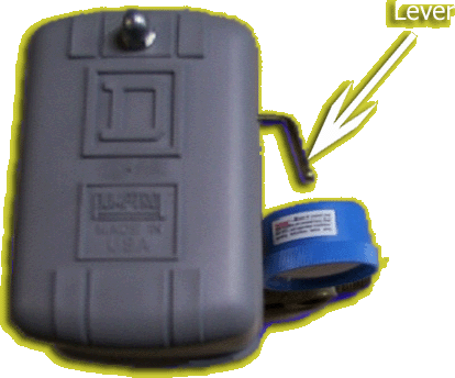

Power outage was restored but no water any suggestions how together the pump going ?

Low pressure cutoff?

Our pump had a set of fuses that blew once when the power went out and came back. Could be something like that?
